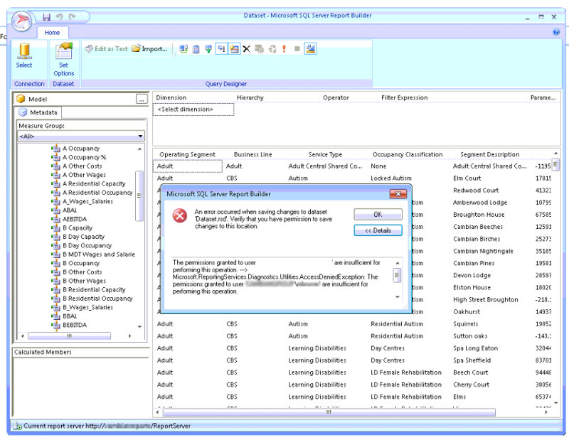

I have a client running a query in Visual Studio and gets the following error " An error occurred when saving changes to dataset.rsd.Verify that you have permission to save changes to this location

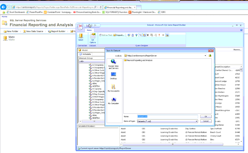

Im01.pngThis is I dont know where the location is pointed to I have the URL and have logged onto the server, which is an SQL server but there is no IIS Webiste for http://servername/ReportServer
Im002.pngPlease can you assist me where I am going wrong.

I know where the SQL server is, and I have placed the user into the reporting services for this but it still not working, as mentioned I suspect its a share on the server, that why I would like to access the IIS site for this and then see if somewhere it displays this, hence my question how would I be able to see what IIS server this site would be on

My Colleague managed to fix this problem as it was a link pointing to a SharePoint document which needed to allow permissions

Reason is this was A SharePoint share that SQL was pointing to to save the reports, which never had the necessary permissions
