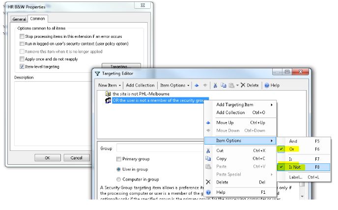

What I did try is making a copy of the printer in GP then setting it to delete for everyone, then higher in the queue it creates the printer again.
aroddick
Yeah you have to be aware of the processing order of each item otherwise it may end up behaving strangely and it will do your head in!
See attached screenshot of our OR and IS NOT rule if it helps at all..
Talds_Alouds
Thanks. So should I simple create a 'copy' of the update printer GP entry and convert it to delete and apply the IS NOT rule?
Walt Forbes
aroddick
Yeah that would be easiest I think, either way should be a pretty quick process. Order the items so that the Delete processes last.
