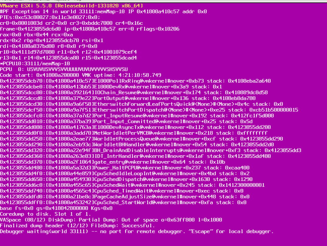

My VMWare Host running ESXi5.5.0 has started to crash every other day.  Not sure why, no physical changes have been made to this server.  I have attached the Purple Screen of Death.  Any Ideas???

Looks like a memory issue to me...

There is also a patch which relates to the specific error message you are getting - might be worth getting this and updating...
It looks like the error relates to the PageFile for VMware, so it is possibly either memory or HDD related.
#PF Exception 14 patch

Look at the top of backtrace? What do you see?
compdigit44
I see the crash message listed world ID 33111, if your log file location is persistant, you could check your vmkernel and VM specific logs to see which VM was using this world ID at the time of the crash.
As other have suggest you could try and change the NIC type of VMXNET3 and see if the crashes stop
