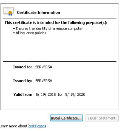

Have SBS 2008 and various versions of Outlook from 2003 to 2013. Two days ago they started to get a certificate error message (see attached Exchange-security-error.jpg)  and was able to create a new certificate with dates from 2015 to 2020. HOwever I am now getting a new error stating that "the name on the security certificate is invalid ( attached new-error-message.JPGnew-error-message-2.JPG) . i can see that the original certificate was issued to remote.steeda.com and that the new one is issued to steeda.com. Indeed there are two DNS zones (attached DNS-settings.JPG but I do not know how to change the reference to remote.steeda.com. I havae found serveral articles related to this subject but I cannont get them to work. Here are some links that I found but cannot get to work. I have enabled the certificate with Enable-ExchangeCertificate -Thumbprint xxxxxxxxxxxxx -services "pop,imap,smtp,iis"

Will SzymkowskiSenior Solution ArchitectCommented:
The reason why you are getting this error message is because the certificate you renewed has a different DNS name then you are using for your virtual directories. The name in the SAN (UCC) cert needs to match the name of your virtual directories.
Once you have this configured properly the error message will not show up.

David AtkinTechnical DirectorCommented:
Hello,
To resolve this do the following:
Open the SBS Console
Click on the Network Tab
Click on the Connectivity Sub Tab
Run the Fix My Network wizard from the right hand side.  You will see an error relating to the certificate.  Complete the wizard to fix the error.
You're getting the second error because you've created the certificate manually and not used the correct name that Exchange uses.

dashmanAuthor Commented:
David, thanks for the reply. I followed your instructions and let the wizard fix the error. However now Outlook is getting a different failure     new-error.jpg. it now shows the remote.steeda.com and the steeda-serversa-ca as before has new dates (2015-2017 rather than 2015-2020) but keeps popping up and when going through the install certificate it does not resolve the issue.
