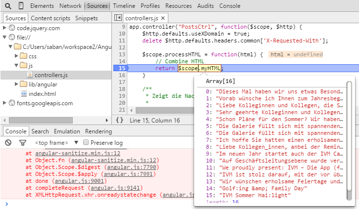

We are approaching! Now, the only unknown is combinedHTML in the processHTML function...
I was guessing at a variable name that you could use to combine the HTML that is in the array. You could use Array.isArray on the input variable to determine if it is an array, and then use for loop to process each of the HTML elements in the array, and build "combinedHtml". If the input is a string, just return that value.
Oh, I know what you mean: $scope.myHTML, which is either a string or an array of strings, both with or without HTML tags. I can see in the debugger that the array is returned back by your function, but the information cannot be shown by the browser (Google Chrome). You see, what I need is the content of this array and parsed as HTML.
1) You would need to loop through each element in the array, and build a string, that you could return.
2) The debugger indicates that the "html" variable is undefined, which would point to a problem in the view.

(257) angular.js:5601 TypeError: a.replace is not a function
at k (angular-sanitize.min.js:8)
at z (angular-sanitize.min.js:7)
at angular-sanitize.min.js:12
at Object.fn (angular-sanitize.min.js:12)
at Object.$get.Scope.$digest (angular.js:7790)
at Object.$get.Scope.$apply (angular.js:7991)
at done (angular.js:9001)
at completeRequest (angular.js:9141)
at XMLHttpRequest.xhr.onreadystatechange (angular.js:9111)(anonymous function) @ angular.js:5601$get @ angular.js:4698$get.Scope.$digest @ angular.js:7802$get.Scope.$apply @ angular.js:7991done @ angular.js:9001completeRequest @ angular.js:9141xhr.onreadystatechange @ angular.js:9111
