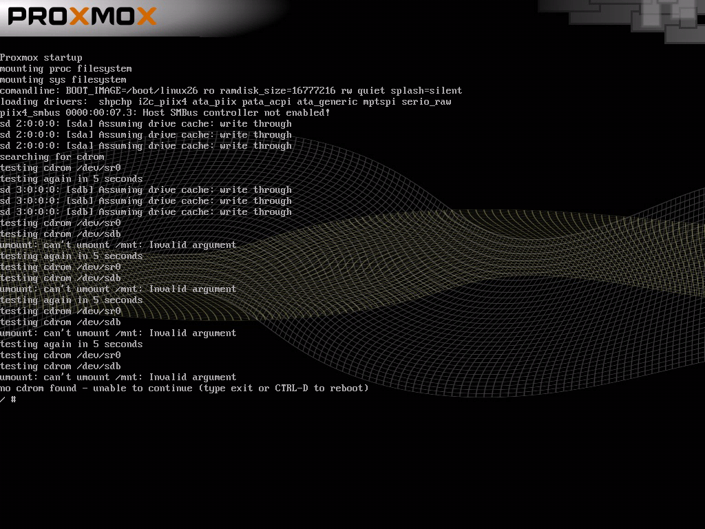

I Tried the "ISOMASTER" version here:
Version 1.3.13
It works alright to create an ISO size, as the source, but when i try the new ISO, it boots up , after making the selection at the first menu i get this error:
chroot: can not execute /sbin/unconfigured.sh execute format error
We tired with another expert to solve this but we could not, maybe you can have a look please.
Thank for your time.

Avatar of NetRock6NetRock6🇨🇦
Hi...
Great work. Finally a bootable ISO....!
However,  I booted from the ISO, clicked on the install.... option in the menu, once, it loads the files into the memory, i get the attached snapshot.
I created an ISO by replacing the [boot] directory and all the files in the root like: COPYING,efi.img.....etc. total of 9 files. Then, used the VM, booted from the ISO file.
Avatar of gheistgheist🇧🇪
I do not understand attachment to ISO files.
You made such a perfect screenshot that I doubt you wrote ISO file to a physical DVD. Why not netboot? no squeeking mechanical parts involved....
First you need a bootable disk, there is no place for compression so far - a boot file that reads kernel and mkinitrd from ISO filesystem using BIOS facilities. So far so good - it works for you.
Why you compress boot loader code - I dont know. You save like 10MB compressing initrd and much less before that.
That mkinitrd must contain *ALL* possible CD drive attachment drivers, yours has only support for very old onboard intel PIIX IDE controllers. Not to mention it needs to treat all possible target disks same way.
I assume you manage drivers part and DISABLE compression at all early boot stages.
Now you either need a directory on CD with compressed packages (like centos, debian etc) or do extra leap to mount compressed filesystem image (like Mint or Mandriva or Suse does)
