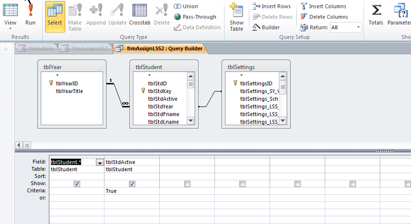

On the form change the Recordsource to
SELECT DISTINCTROW tblStudent.*, tblStudent.tblStdActive FROM tblYear INNER JOIN (tblStudent INNER JOIN tblSettings ON tblStudent.tblStdYear = tblSettings.tblSettings_SY_Year) ON tblYear.tblYearID = tblStudent.tblStdYear WHERE (((tblStudent.tblStdActive)=True));
and change the Property DataEntry from Yes to No...
No VBA
Take a special attention to the keyword DISTINCTROW ... you couldn't change the field because your Recordsource was not updateable due to the fact the 2nd join you have is between fields that neither are keys...

PatHartmanCommented:
tblStudent and tblSettings appear to have the wrong primary key.  If you don't have a candidate key, then using an autonumber is correct.  I prefer autonumber PKs in almost all instances.  But, occasionally I have a candidate key that includes multiple columns.  In those cases, I create a unique index to enforce the business rules.  It looks like you are using autonumbers because someone told you that you should but in your mind, some other column is the primary key.  Either remove the autonumber entirely and make the other field the PK or, add a unique index for the other field.  I find that when my candidate key is a single column, it is better and less confusing all around if I simply use the candidate key as the primary key.  When you use some other column as the primary key, you must delete the autonumber.  Autonumbers will eventually generate duplicates if they are not the PK.
