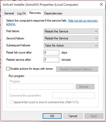

There are a couple of ways to do this, however, before you get into the programming aspect of it, why not just utilize the Recovery options available from the Services snap-in?User generated image-saige-

We have it set this way actually but it doesn't restart the service all the time. The failure can cause the service to be down for minutes while it crashes.  When it crashes we need to have it come back up after x attempts.
It seems illogical I agree....we went down this road first before trying to develop an app as a windows service.
My contention is if we wait x minutes and try then repeat until it starts back up we will be good to go.  Give it a "lag" if you will.

That was my fear.  Just to paraphrase to ensure that I am understanding you.  You have a service that will no longer process requests.  Sometimes when this happens the service process stops but at other times it does not.
Does this describe the issue?  If it does, then you are correct, simply enabling the service recovery will not work (unless the executable itself actually quits, if this is the case then you will want to ensure that you have checked the option to 'Enable actions for stops with errors.'
