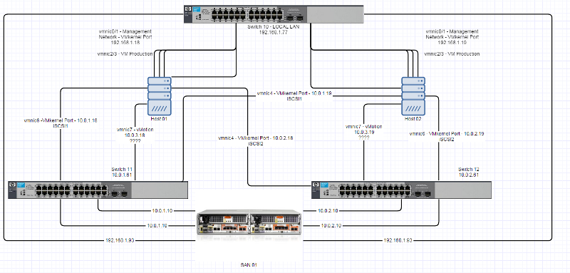

SAN/Host Network of Current ProductionPlease see file "san-host network connections" to see network diagram.  (quick network diagram copy)

Does the above diagram depict an ideal setup?  I would love to know what someone thought of the way it is currently setup, so I know going forward if that person setup it up correctly.

it looks okay to me,  make sure you enable Jumbo Frames, and create iSCSI network as per my EE Article
