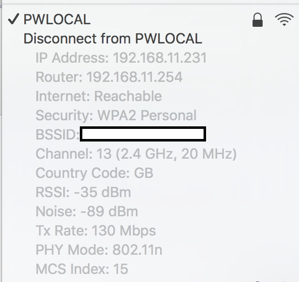

Any result from the Apple wireless diagnostics?
The Option click on the wireless icon would show something like this:

I am so sorry.  I have uploaded the wireless report from my Mac.  Thank you again.
âš¡ FREE TRIAL OFFER
Craig Beck
Your TX rate is 65Mbps.  How far from the AP is the Mac?
