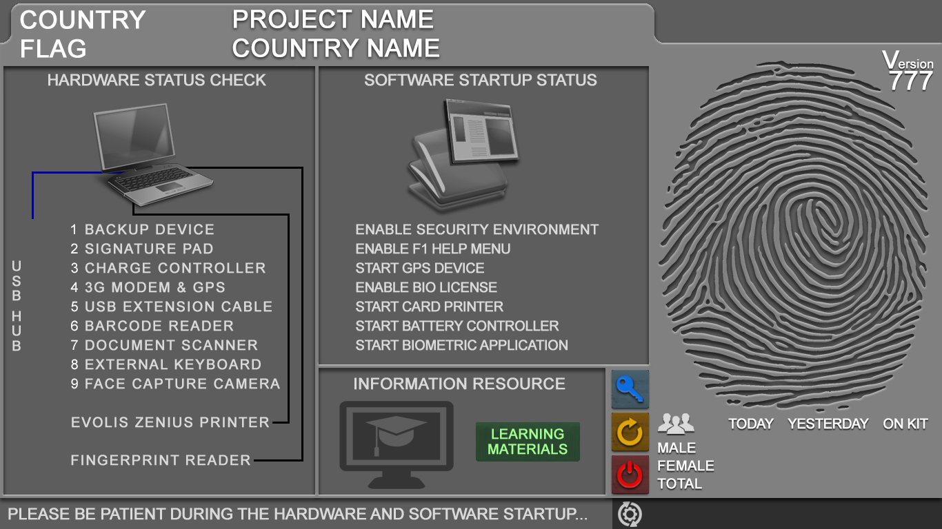

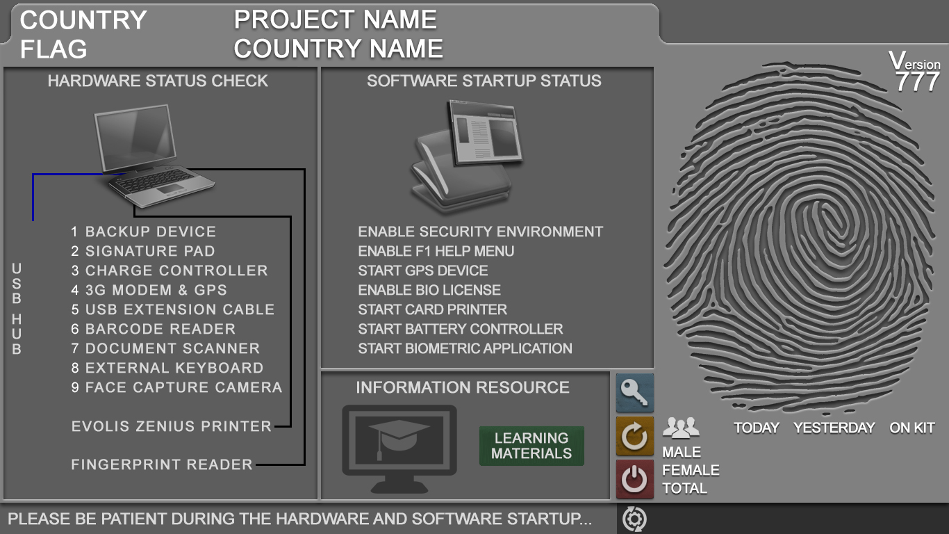

I need a HTML/CSS guru to please help me build 4 buttons in an html. The buttons must be styled differently for Normal, Mouseover, Mousedown (Click)
I have an HTML application (.hta) that contains four buttons. Three of these buttons contain only an icon and the fourth button contains text. I would like to use CSS to style these 4 buttons so that they effectively have three states:
State-1-Normal
State-2-Mouseover
State-3-Click
I have attached three images showing an example of what I'm roughly trying to achieve.
The four buttons is part of an .hta. I attach a sample of the working .hta with the best buttons I could muster by myself. Just extract the .zip to a folder, rename the Screen.txt to Screen.hta and run it. You will then get a good idea what the end product will look like. The buttons I built does not have a mouseover or mousedown(click) effect as I would like them to have. Basically I would like these buttons to behave and look like real buttons. I also built the whole button as an image but I would preferably just like to have a .png of the image and generate and style the remainder of the button with CSS/HTML code. (I believe that is the correct/best way of doing it?) The buttons need to be positioned with X and Y coordinates.
All the current code and images is inside the .zip. Be careful when you click the buttons as their function is to LogOff, Restart and PowerOff your PC. The fourth button does not currently have an action and it is ok if it just clicks but not perform an action.
This .hta have mostly been developed with help received from E-E and I am grateful for additional help as I  (we) build this further.

This is the current .hta with buttons that look and work bad. Just rename ScreenV10.txt to ScreenV10.hta. Watch out, clicking the buttons will either Logoff, Restart or ShutDown your computer. I did not know the correct way to disable those actions for testing. To terminate/close the .hta just press Ctrl+F4.

your css code does not take effect because the image is "in front" of the background.  Your LogOffB.png has a grey background.  if you just had the blue key on a transparent background then your code below would work.
.btn-log-off:hover {
      background: url("LogOffB.png") no-repeat center #3E535E;
.btn-log-off:active {
      background: url("LogOffB.png") no-repeat center #32434C;
Avatar of Rebel_no_1
Rebel_no_1
Flag of China image
No, all 6 .png files has transparent backgrounds. Please check the last E-E Sample.zip file. I am fairly sure the .png is used as an "icon" and the actual square button is drawn with the code:
.btn {
	   width:55px;
	   height:55px;
	   position:absolute;
	   display:block;
	   padding:5px;
	   -webkit-border-radius: 3px;
	   -moz-border-radius:3px;
	   border-radius: 3px;
	   border:0;
Avatar of Rob
Rob
Flag of Australia image
Could you use something like this: http://jsfiddle.net/gdakeja6/embedded/result/
(http://jsfiddle.net/gdakeja6/output/).  This uses essentially a font (glyphicon) to render the color of the icon and its background.  I couldn't find the same logoff icon to use but this would give you ultimate flexibility on styling.

Rob, that works 100% and I am ok with the different icons. How would I put that into my code though? How do I maintain the click action? Below is the current script. I just need what you just showed me in that and I will be a very happy man!
