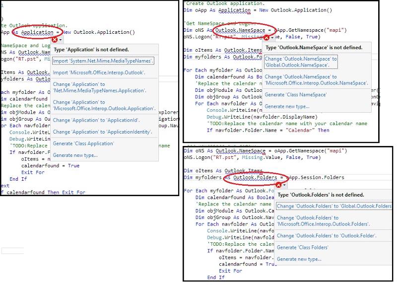

Tried it but it gives errors (see pix below):
Here the code:

Where are going wrong?
Avatar of Karrtik IyerKarrtik Iyer🇮🇳
I am assuming your using visual studio and VB.NET (not writing VBA or macro code in outlook)
Also please give your calendar name appropriately, by default all calendars have name as 'Calendar' so try to give your iCloud calendar a different name and try to use the same in the code below.
1> First error: Expression is of type Outlook.Folders, which is not a collection type.
Please add reference to Microsoft.Office.InterOp.Outlook assembly to your project.
Right click your project in solution explorer and click on add reference and select the above mentioned assembly
And import following namespace at the top.
Imports Microsoft.Office.Interop
2> Second error: oAppt is not declared
Remove oAppt = nothing at the last line, not required since not used
3> Please use modified code below.

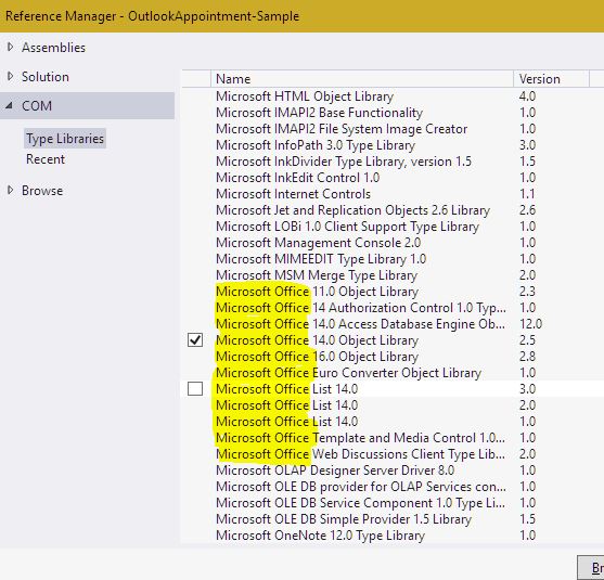

the Microsoft.Office.InterOp.Outlook not in "add reference" instructed (see pix below)
"...give your iCloud calendar a different name and try to use the same in the code below"
Based on the pix below of our Calendars, what name should we use?

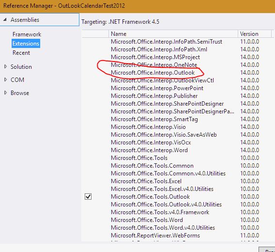

1> Not in COM , go to Assemblies at the top.
2> For correct calendar name, just iterate through once to see what all calendar names are getting printed and then based on that we can find out which one is yours.
Avatar of janajana🇺🇸
Ok got it!  Added reference.

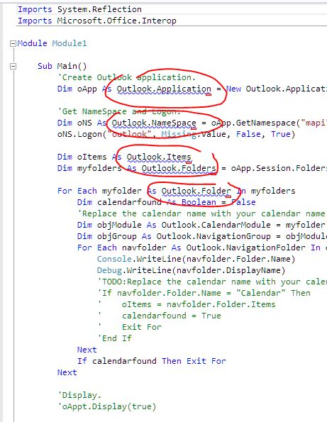

Same "blue" line as in the pix before.
(and we added the reference instructed)
(sorry couldn't continue last night.  Even though desperately to finish this the computer acted up no internet)
Ok, we downloaded your sample and open the 'OutLookCalendarTest2012.sln' solution and added the 'Microsoft.Office.Interop.Outlook'.  Yet when we go back to Right-Click Project >> Add Reference, the reference is not marked (like it was not selected previously).  However, we also marked 'Microsoft.office.Tools.Outlook' as instructed in 'ID: 41391132' and when we go back to Right-Click Project >> Add Reference, THAT reference is reference.
The curious thing is our project has  'Microsoft.Office.Interop.Outlook' reference.
Neverthess, see your sample loaded; still the blue underline:
There has to be something we are missing (sorry that we are not too tech in VB)

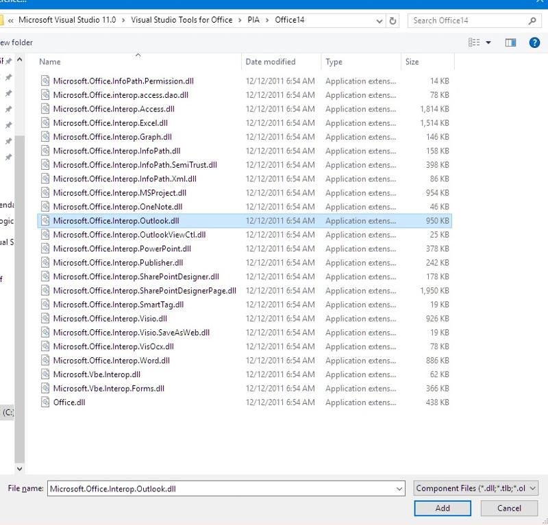

Can you check in your visual studio installation folder whether you have following folder?
The assemblies that we are referring should be inside this folder under Office 12 or Office 14 or Office 15 folder.
The below is an example, in my case it is installed in F drive, please check in your computer based on where you have installed visual studio.
F:\Program Files (x86)\Microsoft Visual Studio 12.0\Visual Studio Tools for Office\PIA\

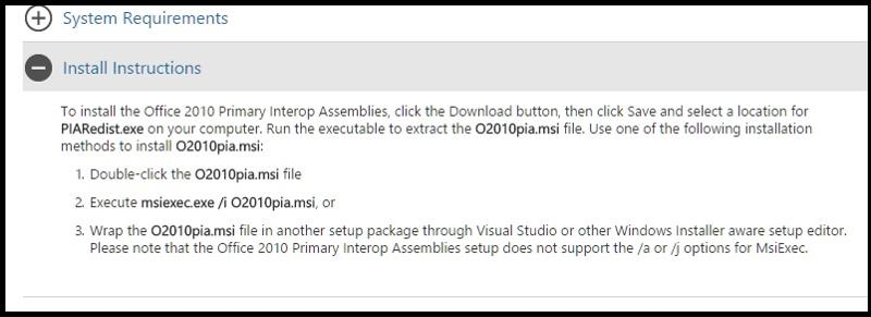

If you do not have the PIA assemblies as mentioned in comment above, then please install (assuming you are using Office 2010) the PIA assemblies by downloading it from the below link.
PIA assemblies for Office 2010
YES (see pix below).

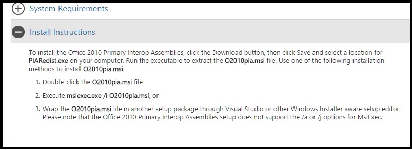

Though we have them, we will download your link just incase. (Note: we had MS2010)

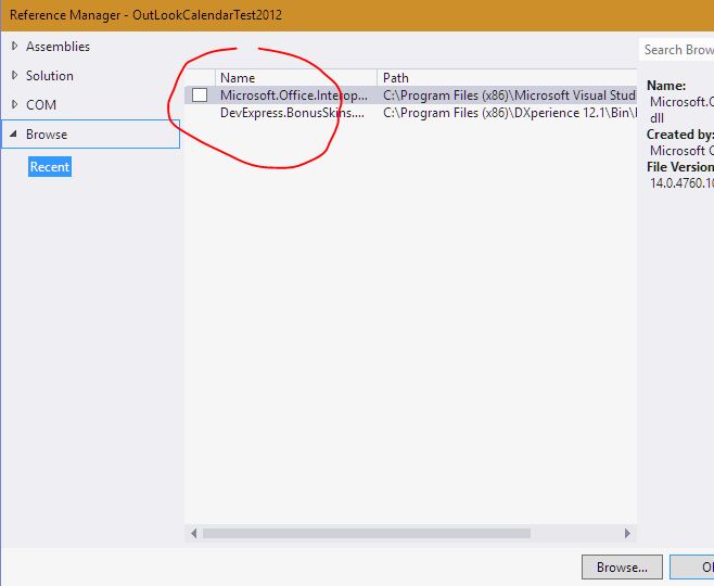

Super strange!
Ok here is the result.
Adding by browsing.  After saving the solution and re-opening, it's not marked.
if we go to the Assemblies Extension, it not marked also.

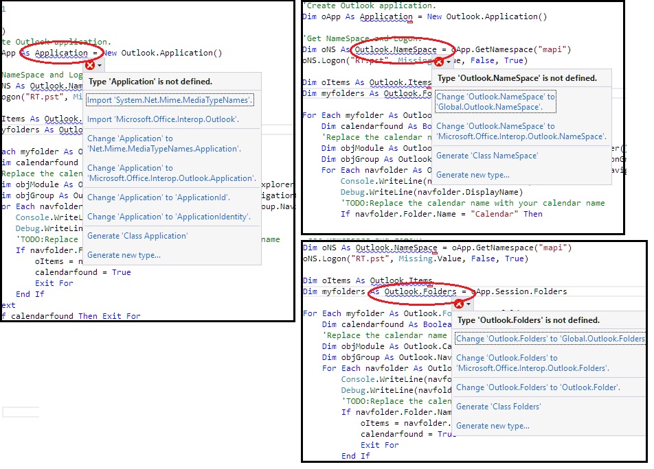

Avatar of QlemoQlemo🇩🇪
Yes Thanx!!! Didn't quite got that and you are right, it's just clicking the suggestion and VB applies the request.

The updated modified code is found  in ID: 41391159 (you can download from there).
The Error are found in ID: 41391583.
Thanx! (Hope u can find what we haven't)
Ok will try
Sorry for the delay.
Just downloaded but read the install instruction and makes no sense:
Should just run the download file "PIARedist.exe"?  or what exaclty do we do with the install instructions MS gav
Ok got it.
Installing!
The points are mutual exclusive. Download, execute, then execute the generated MSI file.
Nope. Didn't work.
Installed it, the installation just showed a windows (see below) and disappear.
went into "add reference", went to folder "C:\Program Files (x86)\Microsoft Visual Studio 11.0\Visual Studio Tools for Office\PIA\Office14"
no luck.
