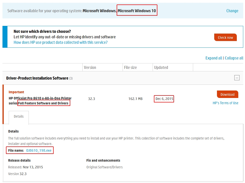

Avatar of Joe WinogradJoe Winograd🇺🇸
Hi Richard,
I suggest downloading/installing what HP calls the "Full Feature Software and Drivers". This will install not only the drivers, but supporting software as well, including whatever scanning software that HP bundles with that particular All-in-One. The download page is here:
http://support.hp.com/us-en/drivers/selfservice/hp-officejet-pro-8610-e-all-in-one-printer-series/5367603/model/5385104#Z7_3054ICK0K8UDA0AQC11TA930O2
Be sure to select W10 for the OS:
It was a very recent release, updated 6-Dec-2015, so there's a good chance that it will work on recent W10 Builds, although I can't confirm that from personal experience. Regards, Joe

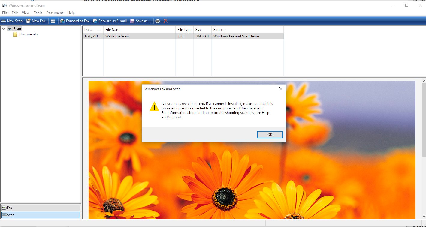

Avatar of Richard KortsRichard Korts🇺🇸
To McKnife,

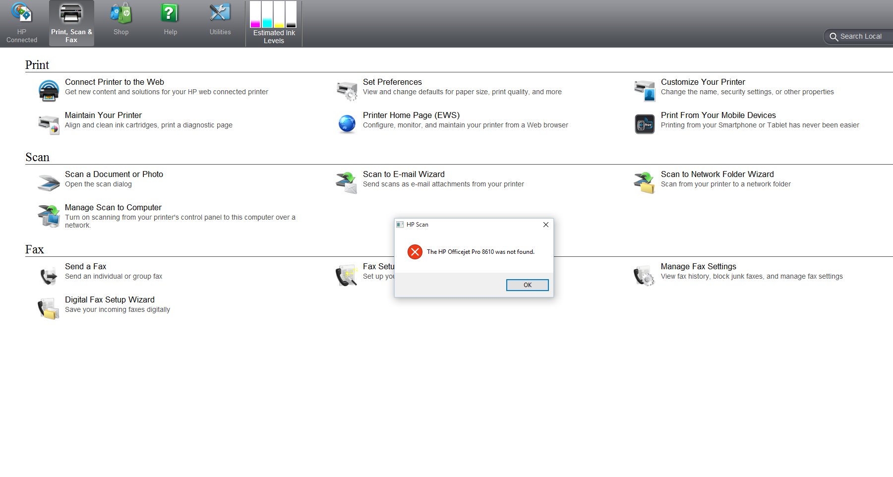

There is no separate driver for the scanner. I did a Google search "Hp8615 Scanner Driver".
It led me to driver for the device , I downloaded, went through all that rigmarole. Took 15 minutes or more.
I get the attached. It cannot scan.
Absurd.
The screenshot shows 8610. It's possible that the same software and driver work on the 8615, but are you certain that you downloaded the right package — for the 8615 and for W10? Also, 32-bit/64-bit matters with drivers — make sure you have the right bit level for your W10.

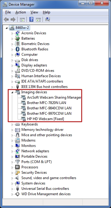

I'd like to see what TWAIN and WIA drivers you have installed. An easy way to do that is with IrfanView, excellent (free) imaging software that I've been using for many years. After installing it, click the File menu, then Select Scan/TWAIN Source.... It will show all your TWAIN and WIA drivers. For example, mine looks like this:
What does your show? Regards, Joe

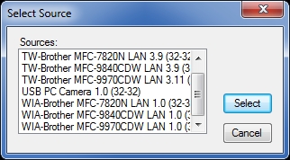

Joe,
I am totally confused.
I went back to HP, made sure Windows 10 was selected, did it again, it almost instantly said I was up to date. So I gather that to mean it thought it was OK.
I know from past experience that HP uses a generic HP 8610 designation for 8615. See attached,

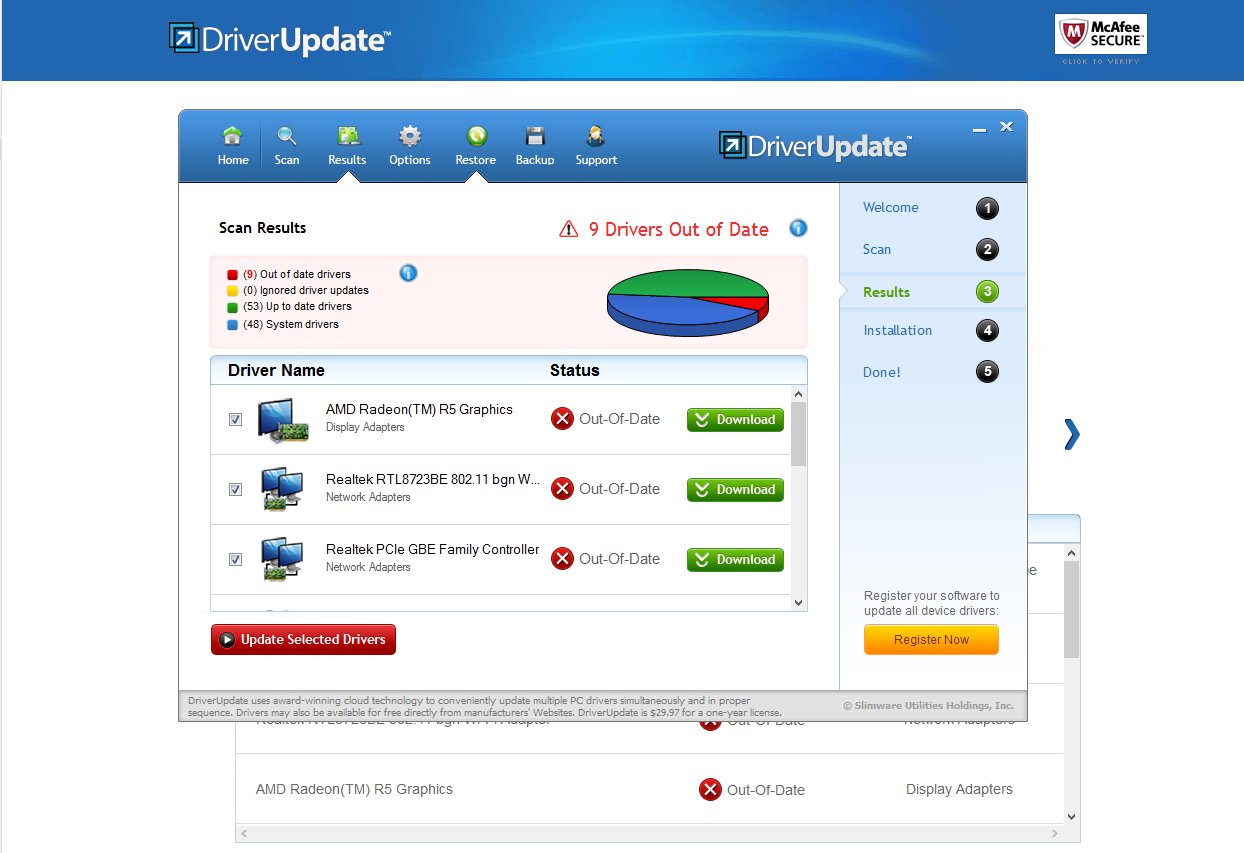

I went to that Infraview link, downloaded, got TOTALLY different things, see attached driver_update.jpg.
There is no infraview app that I can see under apps, I have no clue how you got that image you showed me.
I'm thinking this  "Driver Update" thing may be a virus; should I delete it?

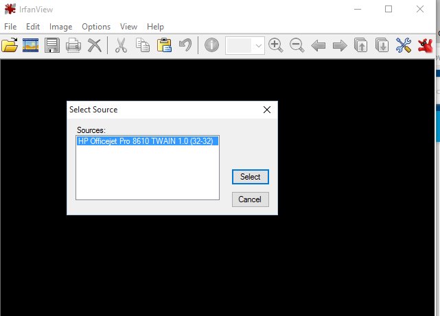

Joe,
OK, I see what I did wrong.
See attached.

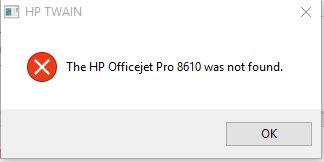

That's good news! You have a TWAIN driver for the device that IrfanView recognizes. Try to scan with it by clicking the File menu, then Acquire/Batch Scanning.... Can you scan with IrfanView?

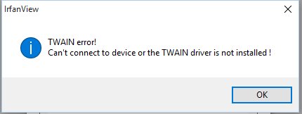

Joe,
I did that, see attached. First error0, then 1.
My reaction is nonsense, I can print, there HAS to be a driver.

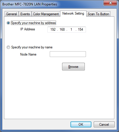

Another idea: maybe your W10 machine doesn't have an IP address for the device. Since it is wirelessly connected, it will have an IP address like 192.168.0.100 or 10.0.1.100 (those are just examples). Read this EE article:
Scanners and Cameras Applet in Windows 7, Windows 8, Windows 10
Run the Scanners and Cameras applet on your W10 computer. Is your 8615 in there? If so, click the Properties button, then the Network Setting tab. Is there a proper IP address in there? For example, mine looks like this:
Now check it on your wife's W7 computer. Does it have the same IP address as your W10 computer? If not, enter the address from your wife's W7 computer (since that works for scanning) into the IP address field on your W10 computer. Does that fix scanning on the W10 PC?

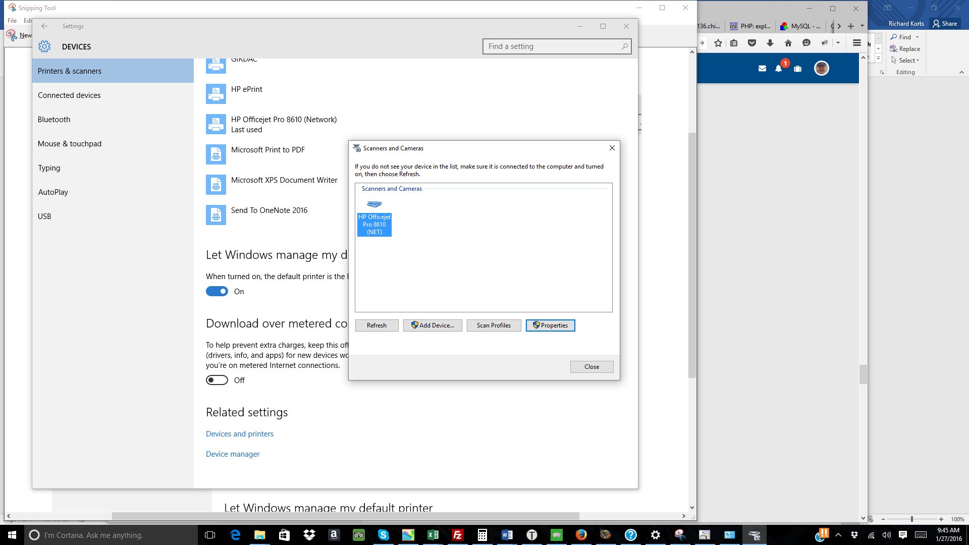

Joe,
I ran the scanners & cameras thing, see attached, I clicked Add a Device, it gave the list at upper left, which does NOT include HP as a choice.
Sorry the screen shot is superimposed on your last EE post.

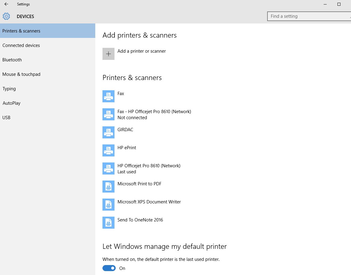

go to start> settings > devices.
If the hp isn't shown, click "add a printer or scanner"
it should appear, click on "add device"
If you click on it in "installed devices", is should offer to download an app for you.

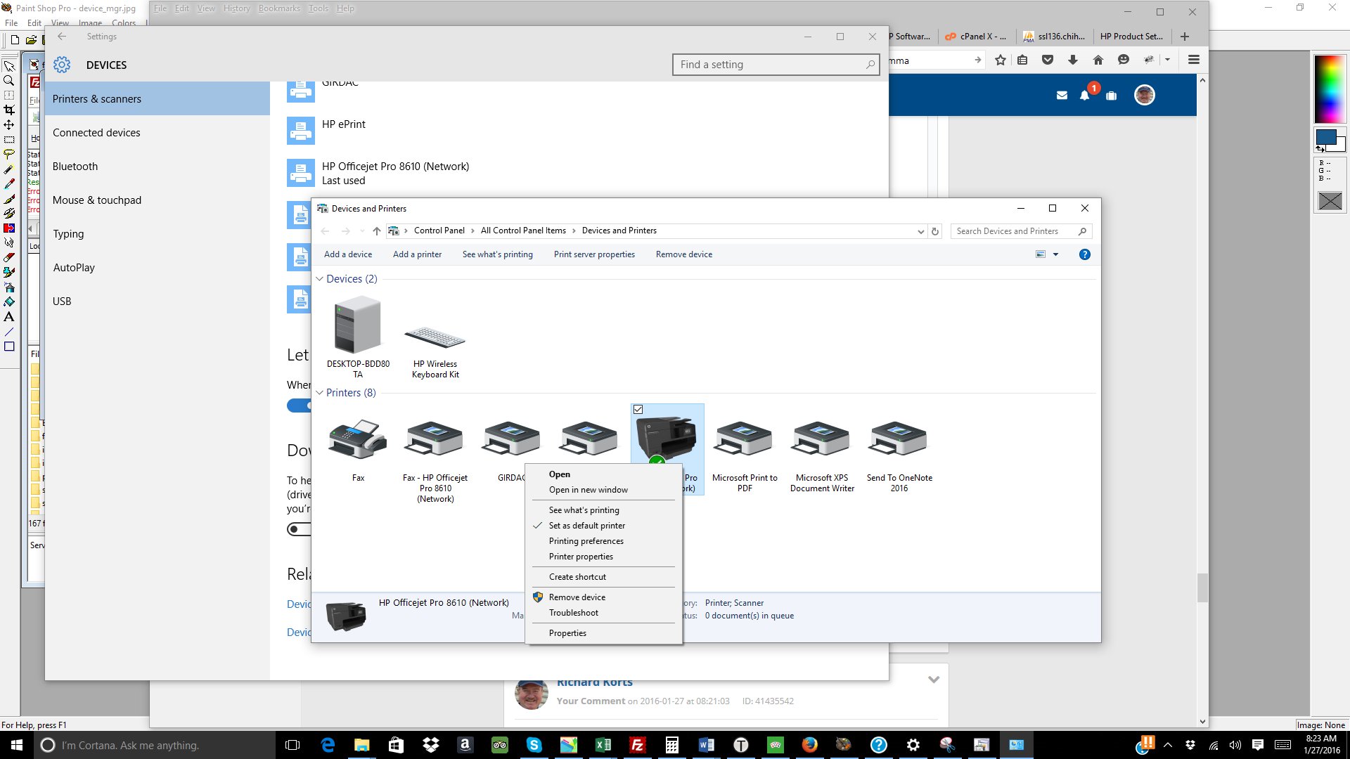

If not, then scroll down and click on "devices and printers", then right-click on the new device, and you should see something like the attached image
wyliecoyoteuk
See attached. This is what I get; HP (or Windows) sometimes calls it an 8610.
Don;t know what to do now.

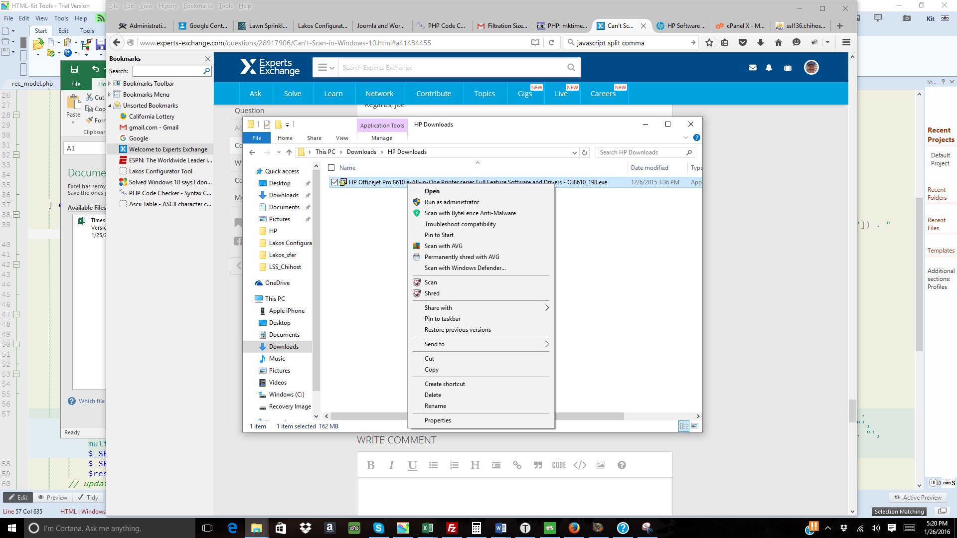

Joe Winograd,
I found the file in my downloads folder.
I right clicked, ran as Admin.
It got to where is said "installing", took about 10 minutes & then failed,
Then I though I'd try as you suggested in compatibility mode.
There is no compatibility tab, or I'm not doing it right.
To Joe Winograd,
See attached.
That's it. :)  Select Properties in that screenshot you posted, then the Compatibility tab.

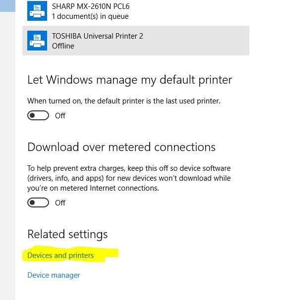

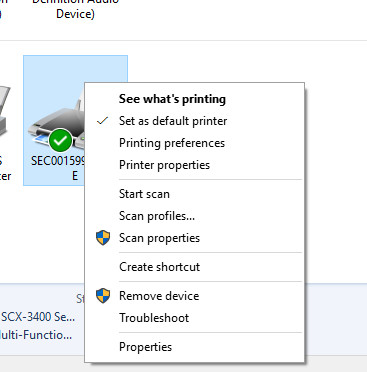

Avatar of nobusnobus🇧🇪
I think that the problem is that the WSD driver is already installed,  and you are trying to install the legacy driver over the top. That is not how windows10 does things. The two are incompatible.
On the printer settings page, the printer is showing as installed.
When you install a web services device, it installs the printer and the scanner simultaneously.
Scroll down to the bottom of that page, click on "devices and printers" under "related settings",
User generated imagethen right-click on the printer. It should have a scan menu.
nobus
See attached. This is AFTER I did the Windows 7 compatibility install per Joe Winograd.
To wyliecoyoteuk
See attached. No scanner.

> plse post a picture of the DM showing camera's and scanners
nobus,
Device Manager doesn't have a Scanners and Cameras section. It has an Imaging devices section:
The Scanners and Cameras applet used to be in Control Panel in XP. MS removed it from Control Panel is W7/W8/W10, but this article shows how to get it back:
> Funny, it shows the scanner.
Richard,
What does it show when you click Properties? You may recall that in a previous post I wanted you to check the Network Setting tab of that dialog, but at the time, the scanner wasn't there. Now that it is, you've made progress! Maybe if you set the right IP Address it will work:
Get the right IP address from your W7 machine that can scan with it. Regards, Joe
