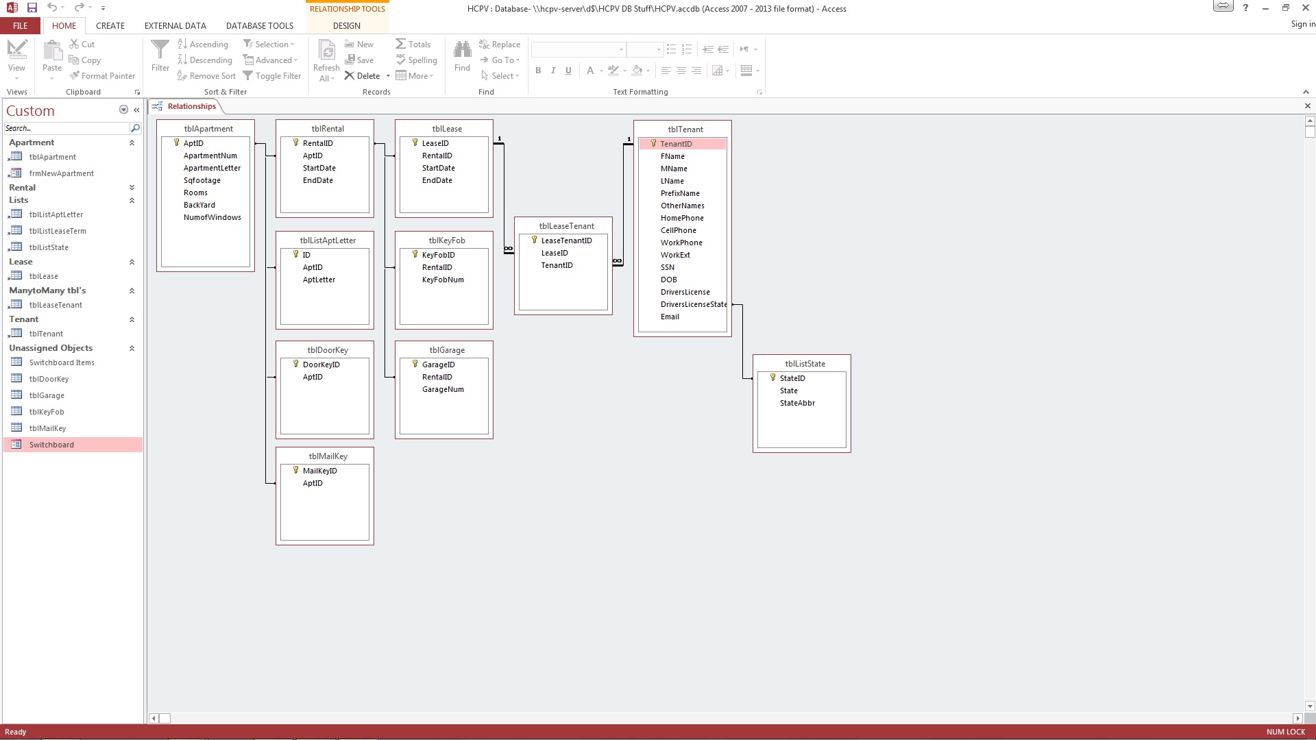

I have a query that I am using to combine fields from different tables. It looks like this...
AptNumLetter: '10' & (Left([AptNum],2) & '-' & UCase(Right([tblListAptLetter.AptLetter],1)))
Problem is sometimes there is no AptLetter which means the query returns nothing in that case.
An example would be 1051-A in that case both AptNum (1051) and AptLetter (A) exist so there are no problems.
But in a few cases there is not AptLetter so nothing is returned at all.
I need to fix this so that it return just the AptNum in the cases where there is no AptLetter.
User generated imageHCPV.accdb

Again, your main problem is - as Pat has mentioned before in another question - your table structure. You should always ensure that you can join between fields where the one-side is a straight AutoNumber. If not, you will continue to encounter issues like this.

Is there a problem with my table structure. From what I can tell @Pat had mentioned that I should not be allowing duplicates under certian circumstances and not in others but rather archive certain records and allow duplicates in the archived table and do not allow duplicates in the non archived area. What he was talking about was a normalization issue. And I completely agree with him on that. It seems like it is this thread you are talking about.
