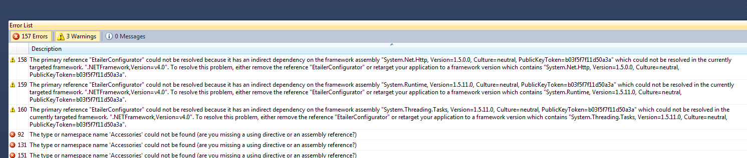

Hello. Recently, while trying to build a project that has a reference to an Assembly generated three warnings (see attached image).
However, when I go to that assembly and rebuild it, it builds just fine. In the project, I remove the reference to the assembly and re-add it, try to build, and get the same errors.
I'm not quite sure how to go about fixing this, especially since the Assembly builds without issue. Everything here is .NET 4.0 in VS2010.
Generically, the warnings are to the effect of: "The primary reference "assembly" could not be resolved because it has an indirect dependency on the framework assembly....which could not be resolved in the currently targeted framework..."

The Etailer assembly uses 4.0 (see EtailerDotNetVersion.png). This compiles and runs just fine on its own. This assembly is used by other, smaller assemblies (all in 4.0).
Ever since I installed the Google.Apis.Analytics.v3 Client Library to the Etailer assembly, none of the other assemblies will compile. Yes, those are warnings I get, but there are 100s of errors because the Etailer assembly code the smaller assemblies are referencing. The warnings and errors have to be related.
Here is a lot more detail. Leaving the "using Google.Apis.Analytics.v3" lines uncommented in the Etailer assembly class, I commented out all the methods that actually use Google.Apis.Analytics.v3 and rebuilt the assembly. Then I went into one of the smaller assemblies that reference Etailer and it built just fine. See (Websites2SuccessfulBuild.png).
Now, if I uncomment the methods that use Google.Apis.Analytics.v3 and rebuild Etailer, that's when everything goes haywire. Again, Etailer will rebuild just fine, but when I try to rebuild the Websites2 assembly, nothing works. See Websites2Unsuccessful.png. Please note the 157 errors (because these are all Etailer objects Websites2 is trying to access. And, of course, i get the 3 warnings from my original post. Websites2SuccessfulBuild.PNG EtailerDotNetVersion.PNG Websites2Unsuccessful.PNG
