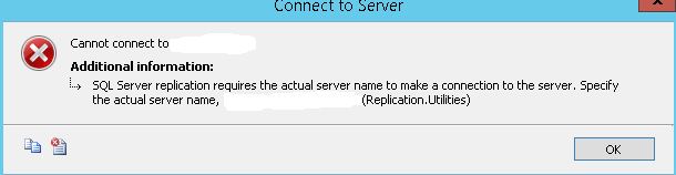

Issue on Replication
Please help me to resolve the issue on Replication. While doing the replication between 2014 to 2012, screenshot attached.
I tried to add server as actual server name as Local, but the message showing as already exists.
Is there any other approach.
Regards
Murali

Check the server name is sys.servers system view.
You have two options:
Option 1. change the server name in replication setup which is showing in sys.servers
select * from sys.servers where server_id=0
Option 2. Change the server in system table using below command.
commands:
sp_dropserver <Server Name which is showing in result>
go
sp_addserver <Server Name by which you connect the SQL instance>, LOCAL
go
Murali Gvr
Thanks Deepak,
 I tried as same as your steps. But i faced same issue. Actually my requirement is 2014 server is subscriber and 2012 is publisher. As of now I tried to fix the issue, but never get to succeed.

Distributor is local or Remote?
Well... can you try by creating the aliase of subscriber at publisher server.
Murali Gvr
Distributor is Local.
Actually Publisher is Local server(2012 Standard)  and Subscriber (2014 Standard) which is Cloud Server(AWS). I used to change the actual server name as 'es' server name. Even I tried to Replication from Local(2012) to AWS(2012) using same procedure it's working on good condition. Please help me how to fix this issue.
Regards
Murali
Deepak Chauhan
for which server you are getting connection error "can not connect to "SUbscriber" or Publisher\Distributor"
Have you checked the local server name.
SELECT SERVERPROPERTY(N'<servername>')
SELECT @@SERVERNAME
also check the server name and network name.
sp_helpserver
Are you able to connect all instance in ssms by the name which you are using in replication?
Murali Gvr
Yes both servers are using on their PublicIP. If we may not used to do Replication, its throwing error. That's why I used to connect using PublicIP.
Deepak Chauhan
Ok. Try by creating Aliase in SQl server configuration manager at publisher server.
Murali Gvr
If create aliase in configuration manager, that it may not effect to server right?
William Peck
Deepak Chauhan
Murali Gvr
Deepak,
 As per your advise I did to change the server name and I finished on replication. Thanks for your support
