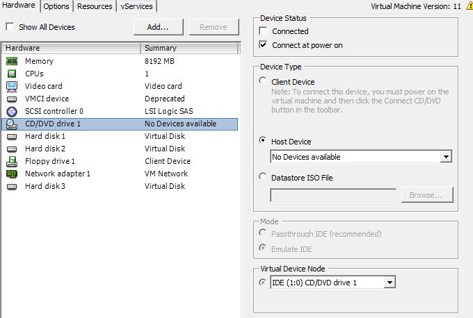

Avatar of cargexcargex
I just check and release the access to this iso file.
But I'm still can't delete it.
This is how the other VMs configuration looks like.
