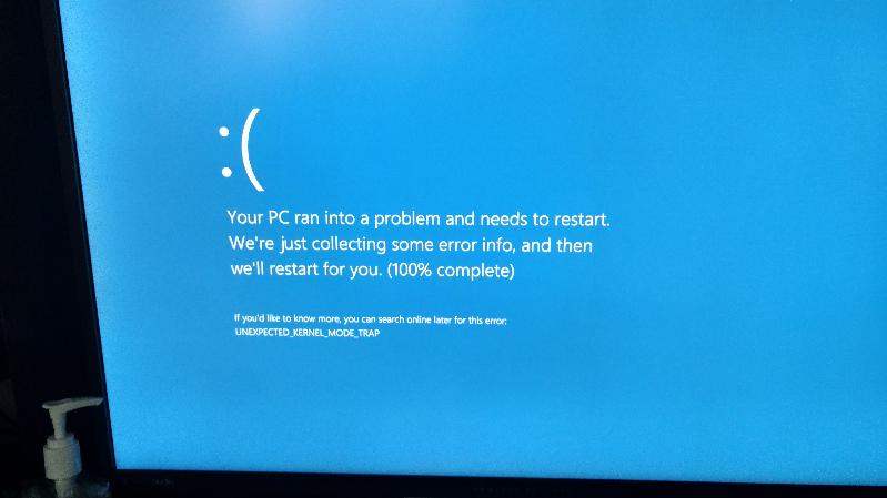

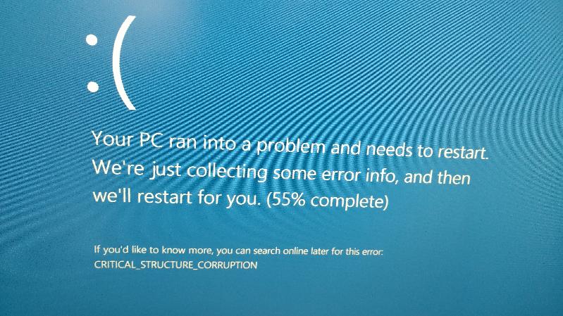

My computer, which is only a few months old, crashes randomly.  It makes a wierd noise through speakers (reminds me a little like a 56k baud modem init sound) for a few seconds, and then it's frozen... whatever is on the screen just stays there and no input devices work... can't remote in via logmein, etc.    On rare occasion I do get a blue screen...  Once it says "CRITICAL_STRUCTURE_CORRUPTION" another time it said "UNEXPECTED_KERNEL_MODE_TRAP"

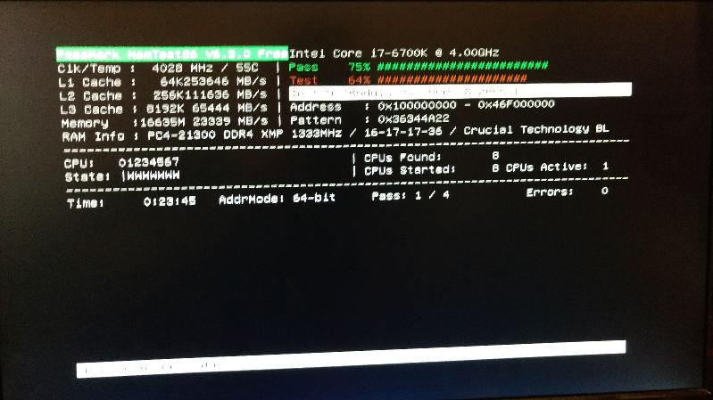

In any case - I decided to run memtest on it, so burnt the iso and booted to it and started it running before bed.... in the morning, as best I can tell it looks like it ran for 23 minutes and then froze.... (though no errors reported)  See screenshot to make sure I am reading it right...

Got spare memory? if so, exchange it and re-test.
Or remove single modules and re-test.

If it's self built, and the fault occurs frequently, try running it with only half the memory installed.  Then, repeat with the other half.

Ill try memtest again and see what happens...
