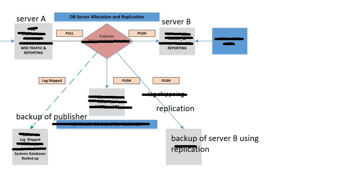

Will do it but let me show you our diagram, I am wondering sth if it works as we have one publisher replicate to
so if we need to protect publisher, Server A and Server B, we should need 3 x AO group and between AO groups, serve can still talk to each other even not all member in any AO failover?
