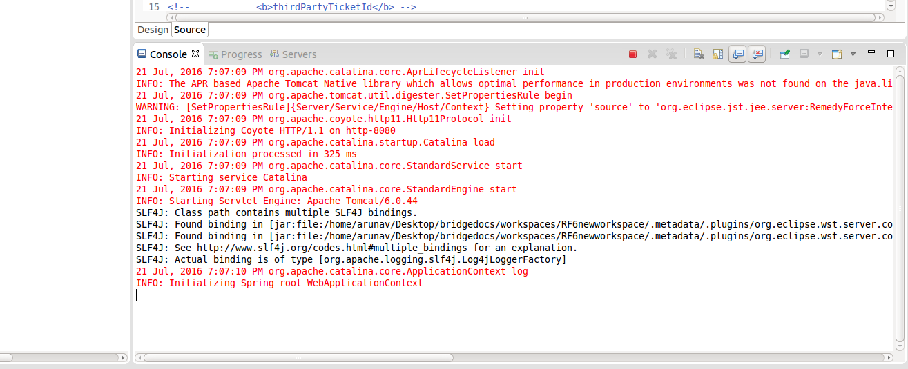

I am trying to deploy a Spring web application to Tomcat 7.0.24 but it hangs upon startup.
Please find the attachment.

Looking at the snap it seems that tomcat is 6.0.44.

I have removed all the applications from the tomcat
With out any application tomcat is starting successfully.
When i change the java version of my appliction to java 1.8 it is working fine.
But actually this application developed with java 1.6 so when i keep version as java 1.6
then it is not deploying properly.tomcat is not able start.
