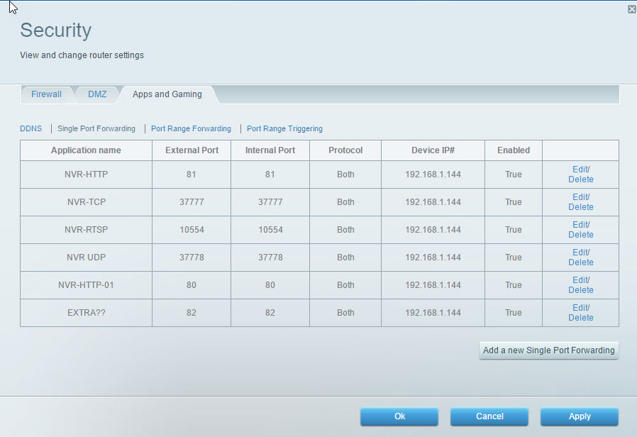

I have a new alarm system. It is cellular based. It works very well from the main panel. I have two remote panels that are very feature loaded. They communicate with the main panel via my WiFi. The alarm company is having great difficulty in making the two remote panels operate consistently. They will lose connection with the main panel. Sometimes for days, then with no apparent reason come back to life again. Both remote panels were replaced with other new ones. Same situation. That is when they told me that those three ports are needed  by the alarm system. I did go into the router and under Games and Security found a table with several entries. I recognized those entries. They were put there by installers of a multi camera video surveillance system with a NVR.
ALL I need at this point is what the two lines I obviously must insert in this table two ports. I don't know exactly what to put in each field.

I would like to try to add those three ports to port forwarding, but I don't know what to put in every field. The far right IP is the IP of my NVR. I DO have the IP addresses of each remote alarm panel.

My present port forwarding table is enclosed.
