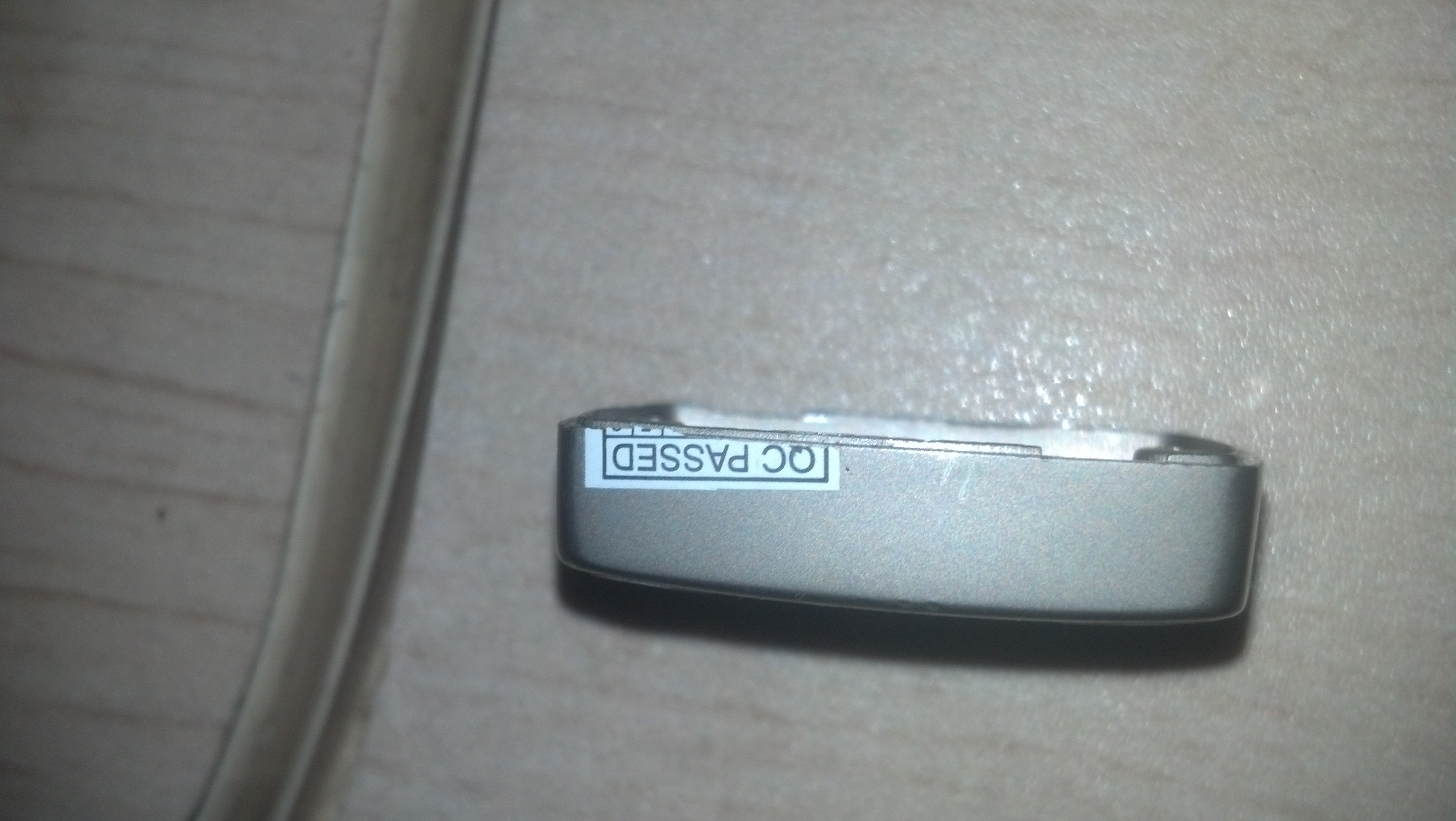

Soddering on the board
P5 does not have any sodder around it, but next to from behind has sodder with nothing attached so I am guessing it goes there?? if so do i take the sodder off to re sodder? or leave it?
Thank You.

It is hard to tell from that picture where it goes.  If that is where the wire goes, you can leave the solder where it is and simply re-heat it to attach the wire and add some more solder, if needed.

What is the make and model of the camera?

This is the only information I found around that camera.

Can you get some more pictures of both sides of the board?  Can you see if you can get some with better lighting and not blurry so that we can try to help you better?

I think its (P5, 5V) where you can see a blob of solder.
Please confirm is it USB Plug and Play?
What are other three 03 wires? What is their connector types? RF?

What are other three 03 wires? What is their connector types? RF? ANTENNA
Yes its a usb plug and play.

P5, 5V where you can see a blob of solder is the correct point.
P6 is the right audio channel for RCA connector.
