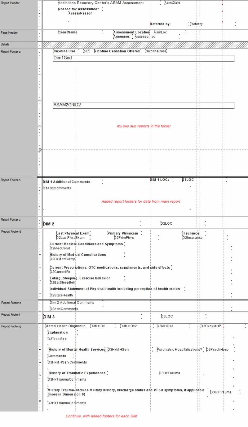

I have a situation where I need to format a Crystal Report to print. The problem is we have a form for a client's Drug and Alcohol Assessment and  this form was created in a proprietary forms designer program where they used three tables to hold the data for this form.
This form has a lot of columns, something like 100 columns in the main table and another 60+ in the other tables. I do not have a lot of experience in CR. In the past for simple reports I would place the column header in the page header and the column values in the details so I can see the values for the different rows in the DB, then I could create a group to see each individual's records.
But in this case, what is important is to be able to print this for auditing.
To start with because there are three tables I used subreports.  Our assessment is set up by Dimensions. There are 6 Dimensions to each assessment. What I want to see is the report Header with general info then the Page header with the name of the Client and the Reason for assessment (and a few other columns), then I want to see the Dimensions of the assessment, so Dim one then Dim two, then three and so on.
But because DIM 1 and 2 are inside of their own tables I needed to use subreports. Which is causing me problems. What I did was I placed the subreports inside of the footer section because this was the only place where the data didn't repeat so Dim 1 and 2 are in the footer area but I have 100 or so more columns to add to the report.
What I did was I then added the rest of the columns (DIM 3 - 6)  from the main table in footer sections that I added i.e., so footer b, footer c, footer d and so on and then I placed the Dim 3 in footer b, Dim 4 in footer c etc., each Dim in it's own footer section. (SEE IMAGE).
While I don't want anything to repeat, I do need to be able to select an assessment from many assessments. And I'm not sure how to set this up. A client may (rarely) have more than one assessment, but we have many clients. So I'll need to have the report setup so one can select a client and see his assessment, and then print it.
As created now using the footers this form simply pulls the first client in the database! I think this is due to not using the details or another type of section correctly. I tried creating a group, and this inserted a group section that repeats the client name (what I grouped on) and this shows the other client's assessments but I lose data and if I select one of the other assessments I still see the data from the other assessment.
Were there no subreports I would place the info into the details section and select from the group selector on the left which should show the corresponding record. But, because I've got two tables that contain the data for Dim 1 and Dim 2 I can't figure out where I would place them.
  First setup that printshow I want it to display

This may be my only option. I've been trying various things going about it using trial and error, and the subreports do not come in unless they are placed in the footer of the main report (as far as I can tell) I've tried placing them in separate detail sections, with suppression turned on, off, etc.,  and the reports don't seem to connect unless they are in the footer? Is that normal? Is that some rule about subreports?
Author Comment
by:John Mahoney
Why doesn't the subreport show when it's placed inside the details section, does it have to be in the footer?

A subreport can be put in any section.  You wouldn't normally put a subreport in a detail section, because then it would (by default) be run for every record, which can be horribly inefficient.  But you _can_ put a subreport there.
 You presumably have the subreport linked to the main report, so that it shows the data for the correct client or whatever.  If the subreport isn't showing in some cases, it might be because of how they're linked.
 James

Have you tried adding a group on the client then a group on the assessment.
You can use the client group header as the "report" header and the assessment group header as the page header.
Put the subreports in the assessment group footer and link them on the client and the assessment.
mlmcc

Thank you for your help. It's strange but if I place the subreport anywhere but in the footer the data doesn't show up! The subreport works if I place it either in the group footer, or the report footer, but if I place it anywhere else, it fails.
The reason I wanted the report to be inside the details section is to be able to look through client's and their assessments. So, each subreport would indeed be run for each record.
I will try your suggestion and see if that works. But, it's weird that the subreport breaks when placed anywhere but the footer.

Like I said, you presumably have the subreport linked to the main report somehow (eg. using the client field).  If so, the results that you get from the subreport can vary, depending on where you put the subreport (because the current record at that point has different values in the linked fields).
 So, how is the subreport linked to the main report?
 James

Tough one, I had to rebuild the views, and make changes to some of the joins. Thank you for your help here.
