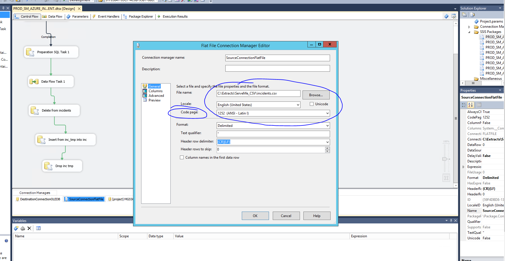

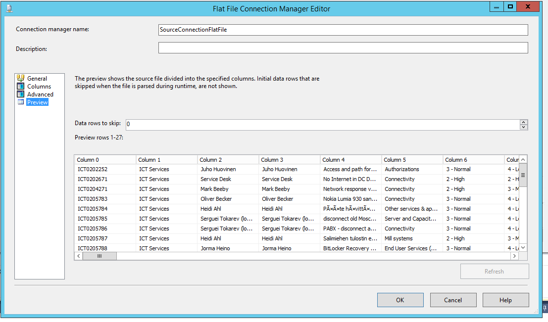

SmashAndGrab
I have been tinkering again.
I created a new package from scratch as you suggested using the import/export wizard as this is a very simple package in what it does.
1.  For the import of the CSV file to the TEMP sql table I used the UNICODE datatype that you suggested..
Is ask's here to select the code page type..  I am leaving it as default as I dont know if it should be something else?
Next:
Preview:
Re-run NEW error:
Could this be a problem with the code page type when the CSV file is being produced?  Should it be something else perhaps?

SmashAndGrab
Code Page type from a text editor.
