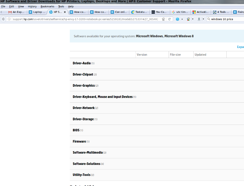

Something else you could do is to download all the Windows 8 drivers from the HP site, then install those. It is possible that there are still some leftovers of Windows 7 drivers on your system. Normally though Windows updates will also get new drivers, but that doesn't always work.
Or you could download the Windows 10 iso and install from scratch to a clean PC. This gets rid of old leftovers you had from Windows 7 which may be causing issues.

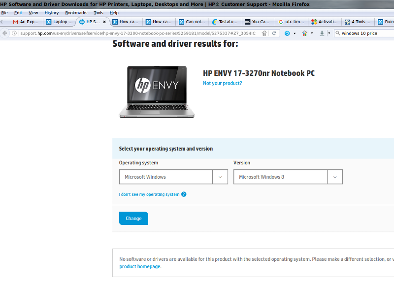

From the main HP support driver download link for that laptop you first get to choose Operating System (Windows), then version (Windows 8). After that you get a whole bunch of drivers for that OS. Of course that doesn't mean you have to install all of those. See my screenshots.User generated imageUser generated image
Avatar of Gary Case
Gary Case
Your first screenshot is exactly what I get =>  See the note at the bottom of that page.  ["No software or drivers are available for this product with the selected operating system."]
How did you get from that page to the list shown in the 2nd screen shot ??
Please post a link to the 2nd page.

I noticed you did that with Firefox, so just for grins I tried it with that as well, but I always get the "No software or drivers ..." message.
Tried it with Internet Explorer, Edge, and Firefox with the same results every time.

As you can see in my screenshot, I have already selected Windows and Windows 8. After that you click on the blue "Change" button just below, and that brings you to the second screenshot. You can see the link in the titlebar of the browser in the screenshot (and it is also in my comment 41751229 that was accepted as assisted answer.
I believe the info on the first screenshot that says "No software or drivers are available for this product with the selected operating system." is based on the OS you are currently running on your PC and not on what you selected above. I'm using a Linux OS and for that you won't find any drivers to download from the HP site. And you are probably running Windows 10 for which there also are no drivers. The message probably just was poorly worded.

Ahh ... definitely counter-intuitive.   But it works fine.  Thanks.
I had wondered how you found the proximity driver ... but clearly see it now :-)

I've also just tested the site while using Windows 7, and there once you have selected the PC model, it jumps directly to the downloads and you don't get to select the OS. So you also don't get the message that there are no drivers for that OS. The page clearly checks what OS you are running and then displays the results for that OS.

Very interesting.     The "Change" button should read "Update"  or  "Show Results" ... and the message that reads "No software or drivers are available for this product with the selected operating system .." shouldn't say "... with the selected operating system" => it should say "for the operating system you're using."
