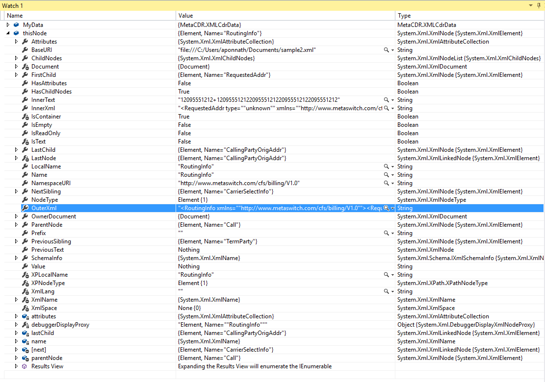

AlexPonnath
that has no impact at all still returns the empty value. in both case the innerXML and OuterXML for the node is the same before changing your code and after
"<RequestedAddr type=""unknown"" xmlns=""http://www.metaswitch.com/cfs/billing/V1.0"">12095551212</RequestedAddr><DestAddr type=""e164"" xmlns=""http://www.metaswitch.com/cfs/billing/V1.0"">+12095551212</DestAddr><RoutedAddr type=""national"" xmlns=""http://www.metaswitch.com/cfs/billing/V1.0"">2095551212</RoutedAddr><CallingPartyRoutedAddr type=""national"" xmlns=""http://www.metaswitch.com/cfs/billing/V1.0"">2095551212</CallingPartyRoutedAddr><CallingPartyOrigAddr type=""national"" xmlns=""http://www.metaswitch.com/cfs/billing/V1.0"">2095551212</CallingPartyOrigAddr>"
           OuterXml
<RoutingInfo xmlns=""http://www.metaswitch.com/cfs/billing/V1.0""><RequestedAddr type=""unknown"">12095551212</RequestedAddr><DestAddr type=""e164"">+12095551212</DestAddr><RoutedAddr type=""national"">2095551212</RoutedAddr><CallingPartyRoutedAddr type=""national"">2095551212</CallingPartyRoutedAddr><CallingPartyOrigAddr type=""national"">2095551212</CallingPartyOrigAddr></RoutingInfo>"      String

AlexPonnath
Ok, i got a bit further and found one problem which was a typo on my side i had one of the node names wrong / missing the "d" in RoutedAddr. After fixing that and resetting my code to the original i get now the inner Text of   "thisNode.SelectSingleNode("ns:RoutedAddr", nsmgr).InnerText" but the "thisNode.SelectSingleNode("ns:RoutedAddr[@type]", nsmgr).Value' still returns a blank value even so i have a value in the XML file
YZlat
change it to:
thisNode.SelectSingleNode("//ns:RoutedAddr[@type]", nsmgr).Value
AlexPonnath
Still nothing, both return blank
YZlat
AlexPonnath
Wow, finaly we figured out this beast..
It returns now the correct value for Type
