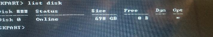

David Johnson, when I run diskpart> list vol and diskpart> list disk nothing returns, it just goes back to a dos prompt.
Disk 0 is of course the Paragon boot recovery disk. But i think I might have made a mistake here, assuming that a recovery disk put together on another machine would work.

in your image ther is no disk 0 -but there is VOLUME 0 that is not the same
nobus
well yes, since it's the onlt drive connected
i thought you meant the volume - if not, my bad
