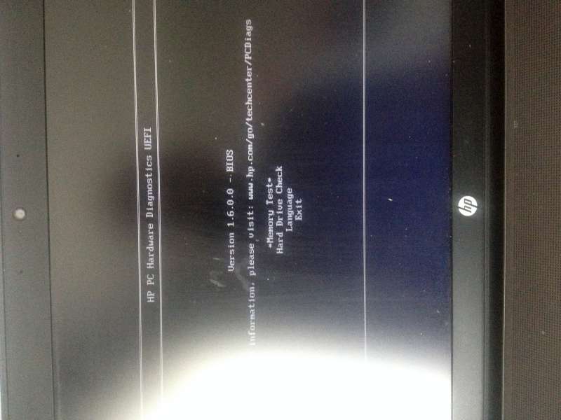

i have a HP probook 450 works fine with windows 7.
however the client wants windows 10 - so i installed  a  SSD 500 Gb with the windows 7 image on it and proceeded to set up from flash drive.  it started setup but gave the error when you see the drive and partitons: cannot create partition"
so i rebooted - to delete ALL partitions, except HPTOOLS and RECOVERY and all of a sudden it Always booted into HP diagnostics - whatever key you hit during startup
so i deleted the 2 remining partitions  -  still the same problems - it would NOT boot form disk or usb -  i only got in the HP diagnostics
HOwever, when i installed the disk with a windows 7 or windows 10 (that was upgraded from windows 7) i got a normal boot, and could access the bios in the normal way with all keys
so it looks like there is some bios or boot info on the disk - influencing the bios access
does anybody see this?
does anybody know why it happens ?  or how to fix this (other than installing an already bootable drive that is) ?

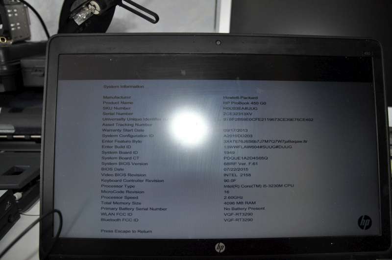

in case it helps, here the info page of bios
info
i must say that uefi bios is a lot more complicated than BIOS - and NOT AT ALL easy to use

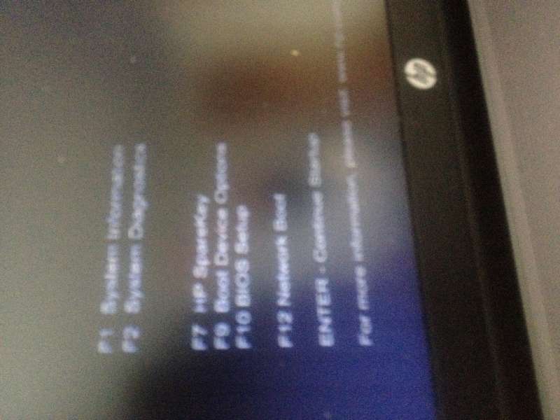

So when you select F9 at boot are you saying you can't select your flash drive? It's normal behavior for hp to goto diagnostic screen if there is no os installed(partition)

You can't if there is no usb boot selection by default in the bios. What are your options when you tap F8 for boot options?
