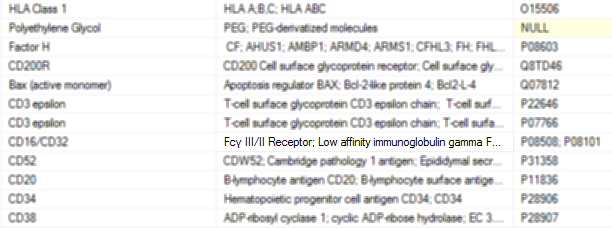

The characters obviously display OK in the source SQL database. Here is how the Synonyms field looks as a record in SQL Server - (the 'γ' of 'Fcγ III/II Receptor' is a greek character):
However, when we export the value of that field using VB.NET - and expose the synonyms field to the console in MS Azure, it displays like this in the log, while the code is running and before it is output to MySQL. Note the 'γ' of 'Fcγ III/II Receptor is converted to '?' .
So this surely suggests that whatever is converting the greek characters to question marks, is doing it at the time when the field value is grabbed from SQL db by the VB code... isn't that correct?
