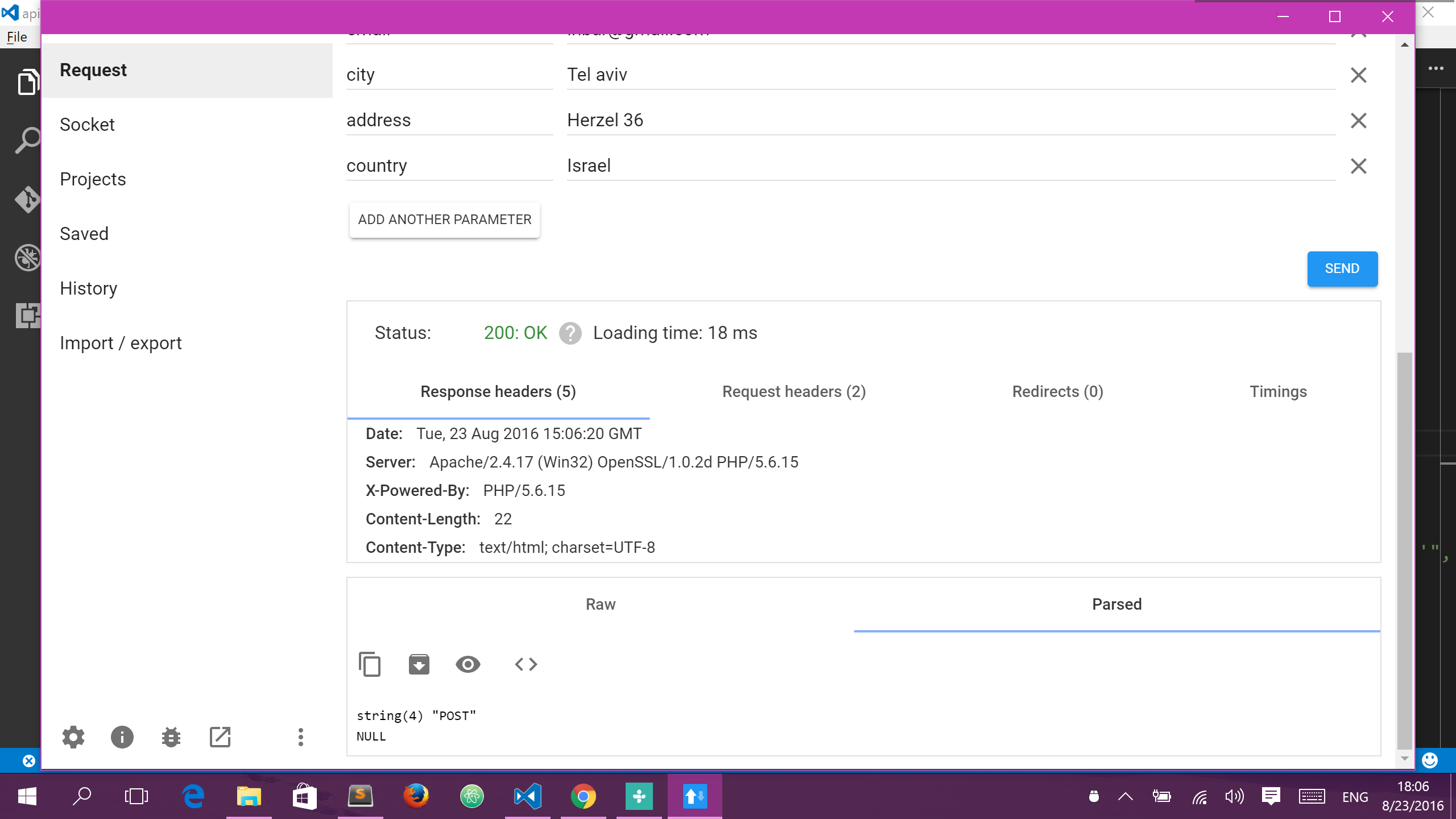

it is the first time i learn how to write an api. i have the folder structure of: apihub/v1/api.php
the GET part works: i get all the customers and a customer according to an id. i have issue with POST variables.
i read that instead of reading POST array one should use : file_get_contents("php://input")
so i have this code:
    $customer = json_decode(file_get_contents("php://input"));
    var_dump($this->get_request_method());
    var_dump($customer);
and when i use the chrome extension i get NULL, but if i don't use the json_decode i so get the json string. what am i missing here? and how can i use that, cause according to it i want to write the query to the database.

gr8gonzo good explanation, yet with your separation, i still get NULL. and with the chrome browser extention i do use: application/x-www-form-urlencoded
ray: i attach the image of bar_dump post. the values are there. so somehow the json_decode return NULL and i don't understand why.
should i just use regular post array, in order to query the database? therefore skeep the decode or totally the file_get_contents? again, the question is why i get the NULL.

Did you try the parse_str line I mentioned? Again, your screenshots show that you are posting form content, not JSON, so try:
$raw = file_get_contents("php://input");
parse_str($raw, $_POST);
var_dump($raw);
var_dump($_POST);
