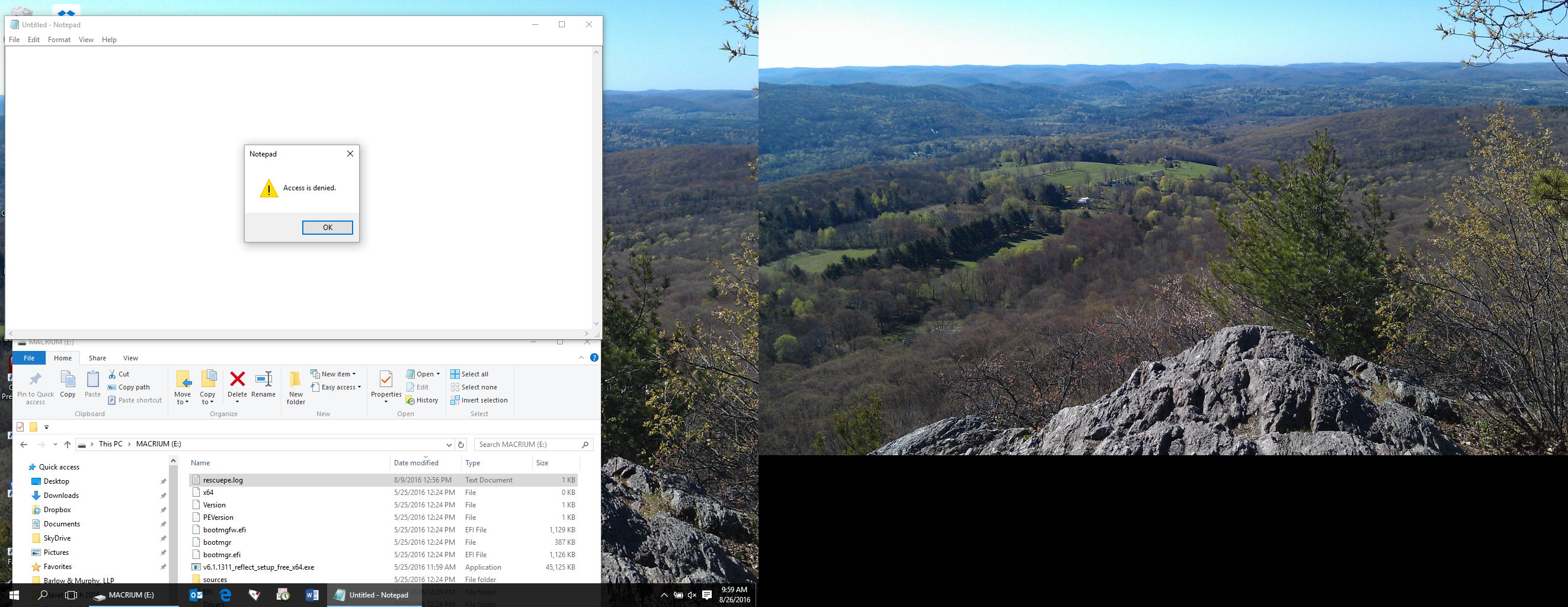

Can't read files on external usb drive files. Access Denied.
I have laptop that recently updated to Windows 10. Everything works fine except for the fact I can't read or write files on any USB removable media. Flash drive, Phone, External HD. I have access to the drives and I can actually create folders but If I try to open an existing file or copy it off of the drive I get the message "Access Denied" or Administrator access required. I can read the media in other PC's though.
I have tried formatting a new USB drive and I made sure that the GP wasn't denying access to the USB removable media but to no avail. I have tried different profiles both local and domain as well but I still can't figure out why I can't open files on USB media.  I
I also tried using TAKEOWN command but it doesn't work on a FAT file system.
Anyone have any ideas what could be causing this?
I attached a screenshot of what is happening.

I can open the drive on other computers as well as the files.
I can open the drive on the laptop in question and view it's contents.  I just can't open the files on it nor can I save files to it. It's not just to a specific device. I can't open, create, or move files on any USB media. If a colleague gives me a flash drive with files on it. I can see the files but I get access denied opening them.

I tried that but it says it can't do it on a flash drive.
