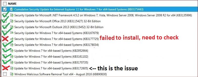

I've narrowed it down to Windows KB3172605 - when this installed, we started getting "Page Not Found". I removed it and we connected. The same scenario is reported in my third link below. This was part of this set of updates:
Windows updates
The page not found error occurred on our development box (with a DOD cert, Sha-1) and on Prod (self-signed cert). So since it fails on both, my conclusion is that it's not the cert.

In addition, we did successfully test a fix with KB3172605 applied, here. This fix updated Tomcat web.xml to add a list of specific ciphers to allow.
