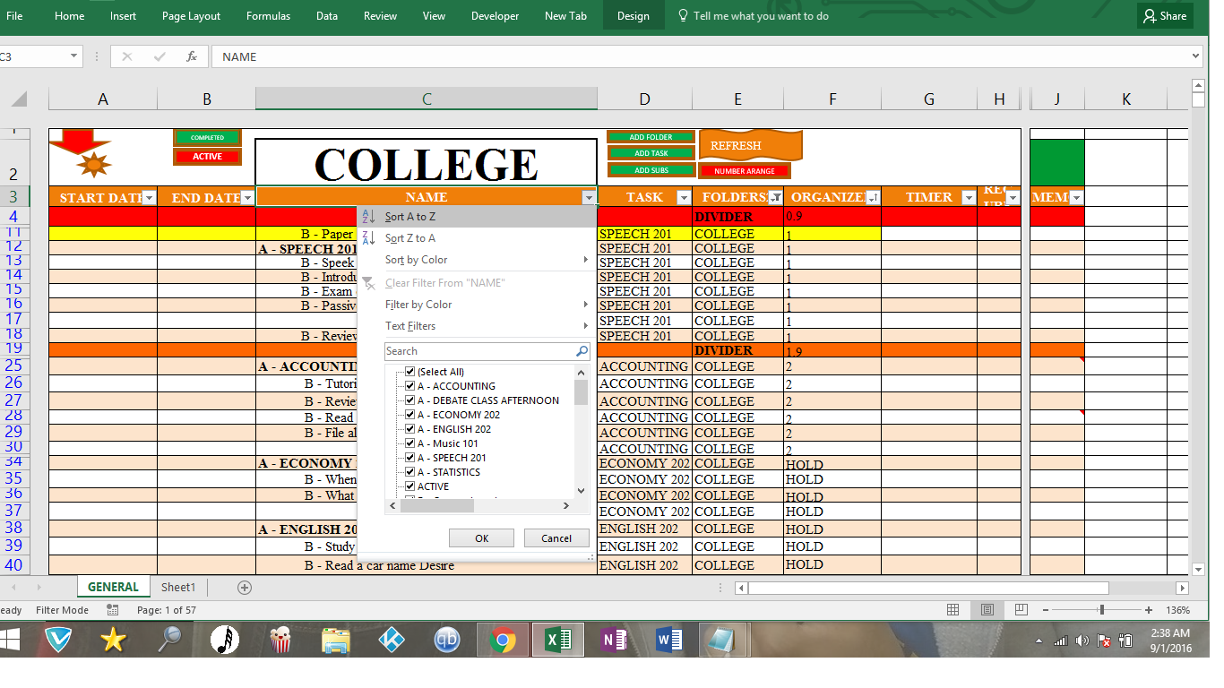

Thanks for the quick response saqib, it now gives me error this code is replacing
Auto arrange
hold
zcompleted
with
"Auto Arrange --"        "Hold --"     "Zcompleted --"
i think that keeping that " -- " is what is giving me the error instead let's just clear it all off and replace it with description without "--"

what i mean by saying  Auto Arrange is the actual button that is on the userform that we are currently working on.
Avatar of Omar Hernandez
the one in color blue

Hello saqib, this code again is doing this
[embed=file 1114732
and then when i close the userform and try to re-open it again it shows this error

Hello saqib i noticed that the main problem is having "--"
if the userform does not find "--" it will continue to act up.
Might as well let's make it work without recognizing or looking for "--" from any particular cell and if there is "--" delete it to add new information.
in other words
have it working by  not having nothing in the cell and continue to work on those cell that is empty or those that has no "--" on cells. If it does have "--" clear it and add description only without "--" on the cell.
Instead of working with
with "--"     "1--"     "HOLD --"    "2--"    "ZCOMPLETED --"
Have it to work like this
if the cell that is being change has "1 --" clear anything in that cell and make it work "1"
if the cell that is being change has "3 --" clear anything in that cell and make it work "3"
if the cell that is being change has "HOLD --" clear anything in that cell and make it work "HOLD"
if the cell that is being change has "ZCOMPLETED --" clear anything in that cell and make it work "ZCOMPLETED"
hope this is more clear Saqib

I don't understand this. You were having problems. How did you overcome them?
sure i just added on the userform buttons that is called Add Task and Sub task another function to add also "--" on the F column so that which ever one did not had a "--" it won't act as if there is an error.
On the auto arrange i noticed that there was no problem but the actual space it had before the number was causing it to not sort correctly, so i just added an additional column so that when ever there is a Task, Sub Task created when using a userform have an additional function. In column "I" if there is a
new Task added add in column I a number "1" with given information of the userform
also for it to add on the following row
same information to D and E row and in column I a letter "z"
new Sub Task when added, add in column "I" a number "2" with given information of the userform.
The first code that you have provided help so much.
