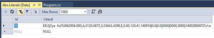

Straight Run -Table Data -
In order to correct as instructed by Andy you only need to convert it to a string literal, unfortunately a simple replace function is inadequate as we are dealing with escape sequences (\0, \r, \n, etc) which, for all intents and purposes, are single characters. This means that we have to find the sequences and convert them to literals which can be accomplished from an extension method; e.g. -
Inside the extension method -What will be stored in the parameter value -What the SqlParameter shows -What the field contains in the database -

Produces the following output -Straight Run -Table Data -

Which then gives you the escape character on the escape sequence and produces the intended output into the field value. Full implementation:
