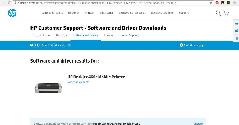

The Software and Driver Downloads page at the HP site for that device is here:
http://support.hp.com/us-en/drivers/selfservice/hp-deskjet-460-mobile-printer-series/466639/model/466640#Z7_3054ICK0K8UDA0AQC11TA930O2
It should detect your OS automatically, but if it gets it wrong, click the Change button on the right:
Then select your OS and Version from the drop-downs that it displays. Regards, Joe
Avatar of Tommy AndersonTommy Anderson
It takes me to this page but the download didn't start it? Also cant find the download button.
Avatar of JohnJohn🇨🇦
Yes, true. It would appear they have pulled the drivers as it is not a supported product. Nothing for XP or higher.

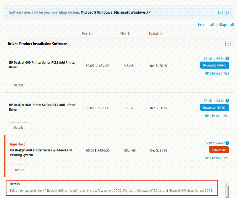

Avatar of Joe WinogradJoe Winograd🇺🇸
It depends on the OS you have, which you didn't specify, or enter as a Topic. If you have W2K, XP, or WS2003, it is there:

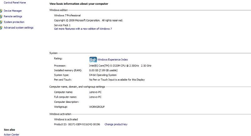

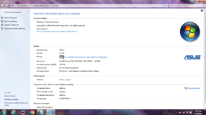

This is my computer.
You are running W7 Pro 64-bit. Your only hopes are (1) if the drivers built into W7 support it (unlikely) or (2) the XP driver (the latest one they made) will work with it in compatibility mode (even less likely, especially since the driver is 32-bit and your W7 is 64-bit). I think you should consider a new printer — that model is circa 2005 — more than 10 years old. Regards, Joe

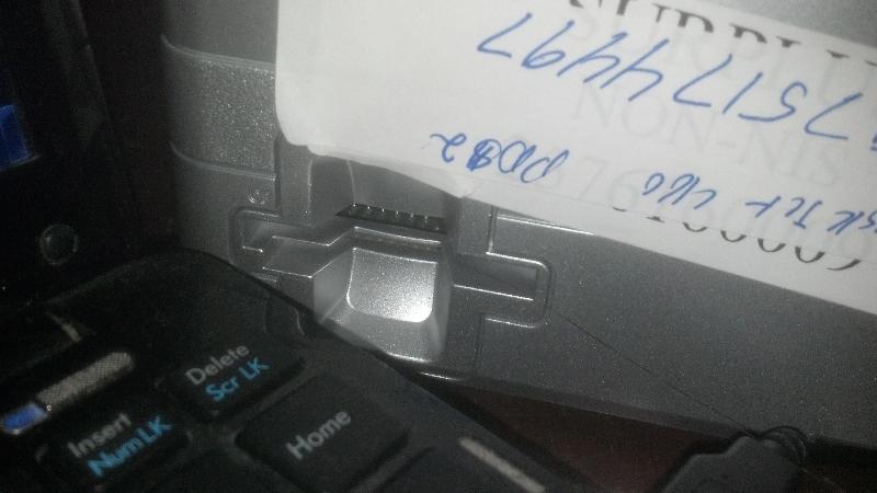

I tried on 32 bit but it still does the same thing. Also I find a slot on the left side of the printer. What is the use of it?

the slot looks like a card reader for 802.11g CompactFlash (Type I) Card, Secure Digital Card, Multimedia Card.
see here the specs : http://h20564.www2.hp.com/hpsc/doc/public/display?docId=c00260823#N1037B

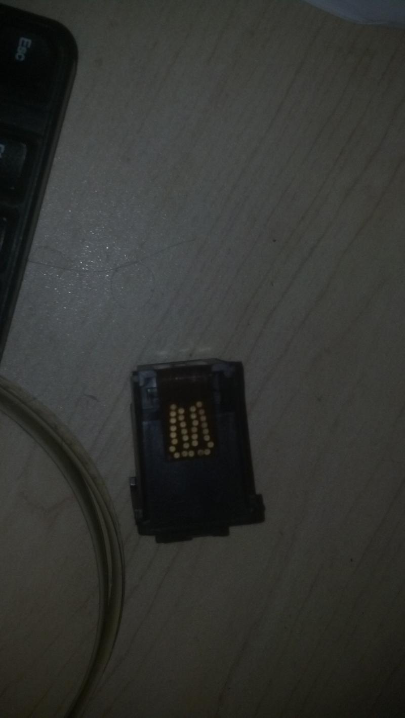

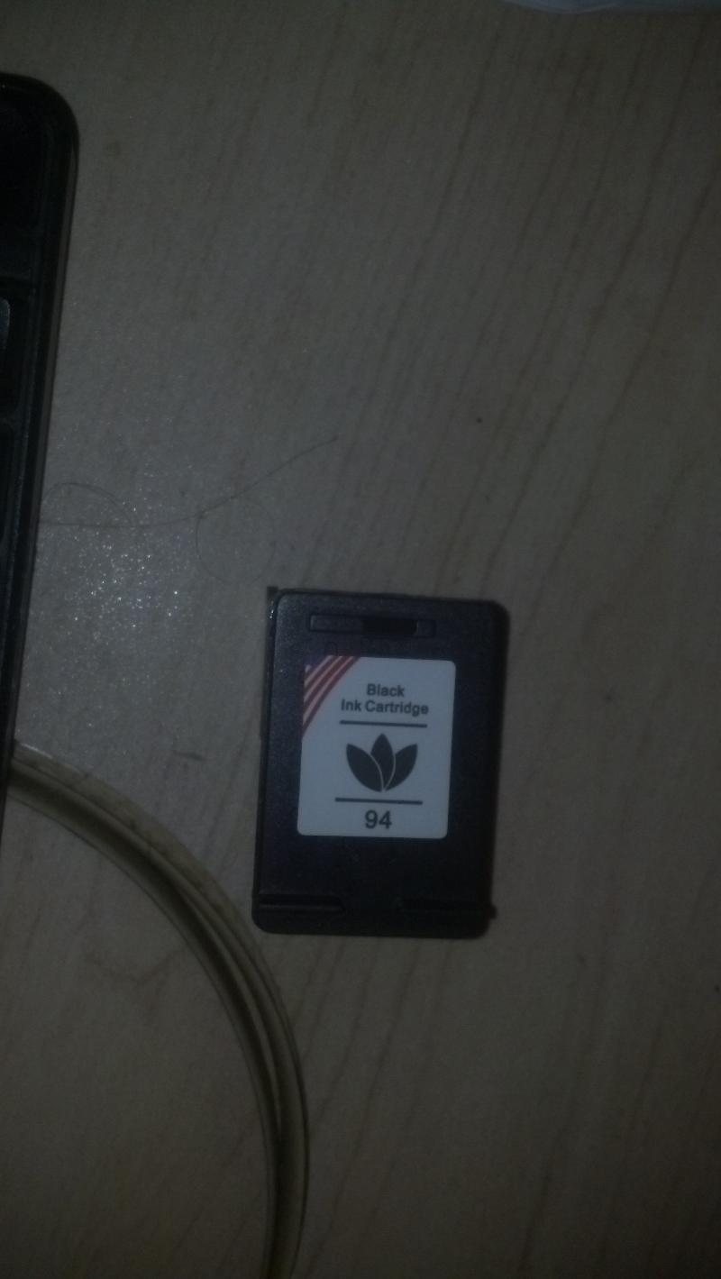

Any idea about that orange light what it means? Not the one which is orange. Its the one on the left.
Avatar of nobusnobus🇧🇪
unfortunately I don't have a manual. Also I reset both cartridges but it still flashing. Do I need to hold the ON button for few seconds or something like that in order the light to go away?
This is a better picture. Light flashing on number 5.
What does the manual say about that?
It says something there is a tape around the cartridge but i cant find it.
Yahoooooooooooooo. Flash light is gone after i reset the color cartridge and its printing.

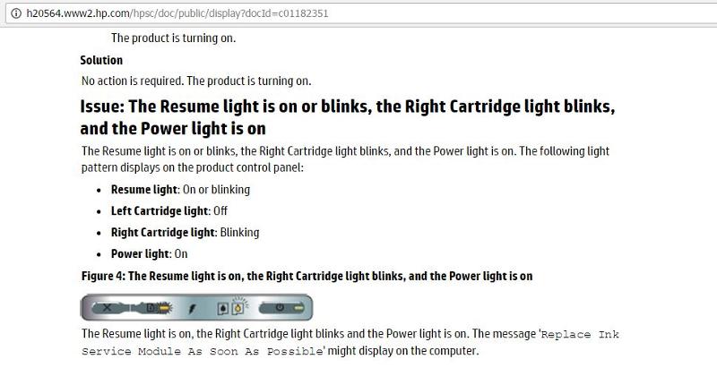

This article documents all issues (and provides fixes) for the blinking lights on the 460. Give it a good read:
http://h20564.www2.hp.com/hpsc/doc/public/display?docId=c01182351
My guess is that you have to do some kind of a reset to let it know that there are new ink cartridges so it will stop giving the low-ink warning. But that's just a guess. I noticed that there's something called an ink service module (I don't know what it is) that may need replacing, followed by a reset of the product. In any case, a careful read of that article should provide the answers.
