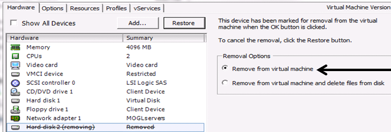

Since the above mentioned question, I spoke with a VMware consultant and it was suggested that I can remove the drive while the VM is turned off; but, choose to not to delete the file.  See screen shot below
screen1
This allows the drive to be removed from the VM but the hard drive will not be removed from the DataStore folder.  These are the benefits of having VMware, it is very modular.

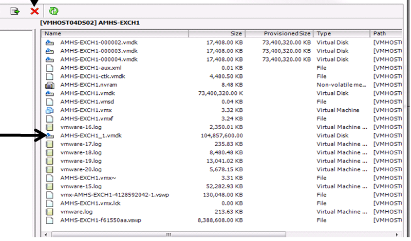

2.      Browse to the DataStore and find the file to delete.
screen2
3.     Select the file and then press the ‘Delete Button’, from the top menubar (Red X

First I would remove from the virtual machine (do not delete from disk!).
and then check for a few days, no access to your drive is required, and then you can safely delete the disk from your datastore.
For your information, virtual disks, are hot plug and play, and CAN BE removed/deleted from an OS, in real time whilst up!
VMware vSphere has NO IDEA, that an OS is actually writing inside to a virtual disk!

I ended up removing the disk last night as I indicated above (while the VM was running).  Everything worked out just fine.  One just must be sure to remove the correct drive and check the setings.
- .vmdk name
- Date of last change  //if it was removed then that date would be the last time data was written to it.
You just need to be careful what you are removing and weigh the potential good vs the potential bad.  For example I would like to remove an drive that is no longer being used on old printer server that is not longer being used in production.  I will use the same process as mentioned above to remove the un-used drive; but, I feel a lot more relaxed in making this change vs an Active Domian Controller.
