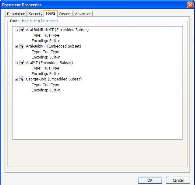

Go to File -> Properties and click on the Fonts tab to see what fonts are being used.

Note that Step 10 underneath the video is the same as what Dave posted. Regards, Joe
