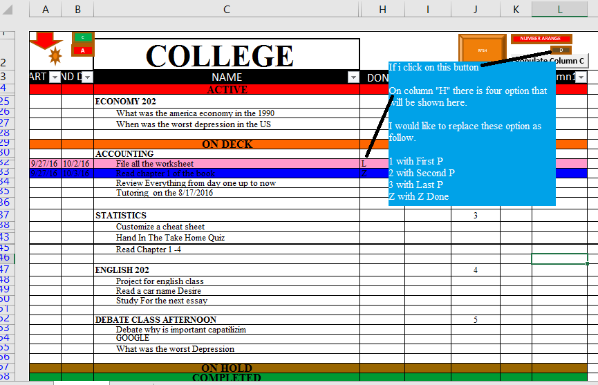

****Description. *****
On column "H" there is four option that will be shown here. if i click on the small button on the file.
I would like to replace these option as follow.

Hey there Neeraj, no luck. If you click on the button shown on the pic on top, it works with no prob, but when it has to do with changing the one letter or number to a whole word it gives me an inconvenience. ***The actual code works with any row
