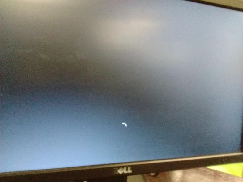

Anniversary Update Apparently Hangs
Last night, one of the office PCs tried to install the Win10 Anniversary Update via Automatic Updates at 3:30 AM or thereabouts. By 8 AM, the black screen with spinning balls (no message) was on the screen and was there til 9 AM when the PC was shut down via the power button.
After bringing the PC back following a few more hard shut-downs to the previous build, the Anniversary Update was forced by going to the Microsoft page and downloading the update - and then running it.
Hard Shut-Downs finally allows previous build to be recovered
After requesting to Update Now, the process ran through up to about 79% before the screen went black and the PC rebooted.  It looked like it would boot all the way to the Desktop;  the Windows Logo appeared on the black screen along with the spinning balls (no message).  But soon after the Logo disappeared, leaving only the black screen with the spinning balls (AND NO MESSAGE).
The HDD LED on the case stopped flickering and trying Ctrl-Alt-Del does not do anything. See the first picture, above.

It hung again.
In fact, a 2nd PC in the office - same hardware configuration, some different software but not much - tried the update via the automatic route last night and it had the black screen with spinning dots this morning, also.  It ALSO has a Logitech wireless keyboard & mouse.
Details:
Found a wired keyboard, but no mouse - so stilll using M310 mouse and K520 keyboard
Insert USB flash drive (with 14393 update)
Run Setup on flash
Choose NOT to download updates
Choose to keep apps and personal files
Let it run
Initial update, reboot;
then black screen with windows logo, then blue screen with update message, updating slowly;
reboots again, black screen with windows logo, then just black screen and only spinning dots, then blue screen at 30%;  screen blinks black at 32% (video driver?), then quickly back to blue;
reboots again, black screen with windows logo, then just black screen and only spinning dots, the HDD LED is solid, then intermittent and then mainly dark - after a flash at about 4-5 minutes later, HDD LED dark again.  I had to leave at that point for the evening.

1607/ build 14393.0  - So, the update did finish on this particular PC.    But not exactly smoothly.
I was not here this morning when it was shut down via power button and then restarted, but the PC is working.  I didn't even get to see the login/Desktop after.
On the 2nd PC, that went thru Automatic Updates, it did not.
Not exactly smooth sailing.
Am attempting to update the 2nd PC (thru Windows Update) after removing the wireless Logitech Unifying receiver and plugged in a set of USB keyboard & mouse.  No Logitech software had been installed - and this is what some other websites have reported with this issue.
PC #2 just rebooted and is now on the blue screen saying Working on updates 32%
Accepted Solution
by:
Robert earned 0 total points
2nd PC completed its update thru Windows Update.
Version 1607 / build 14393.222, so it is up to date, fully.
So, my call is that the wireless Logitech Unifying receiver for the mouse & keyboard - without any Logitech software installed - blocked the Update from finishing.
Unless anyone has a better suggestion - not that I can test it now - this will be the answer chosen.
