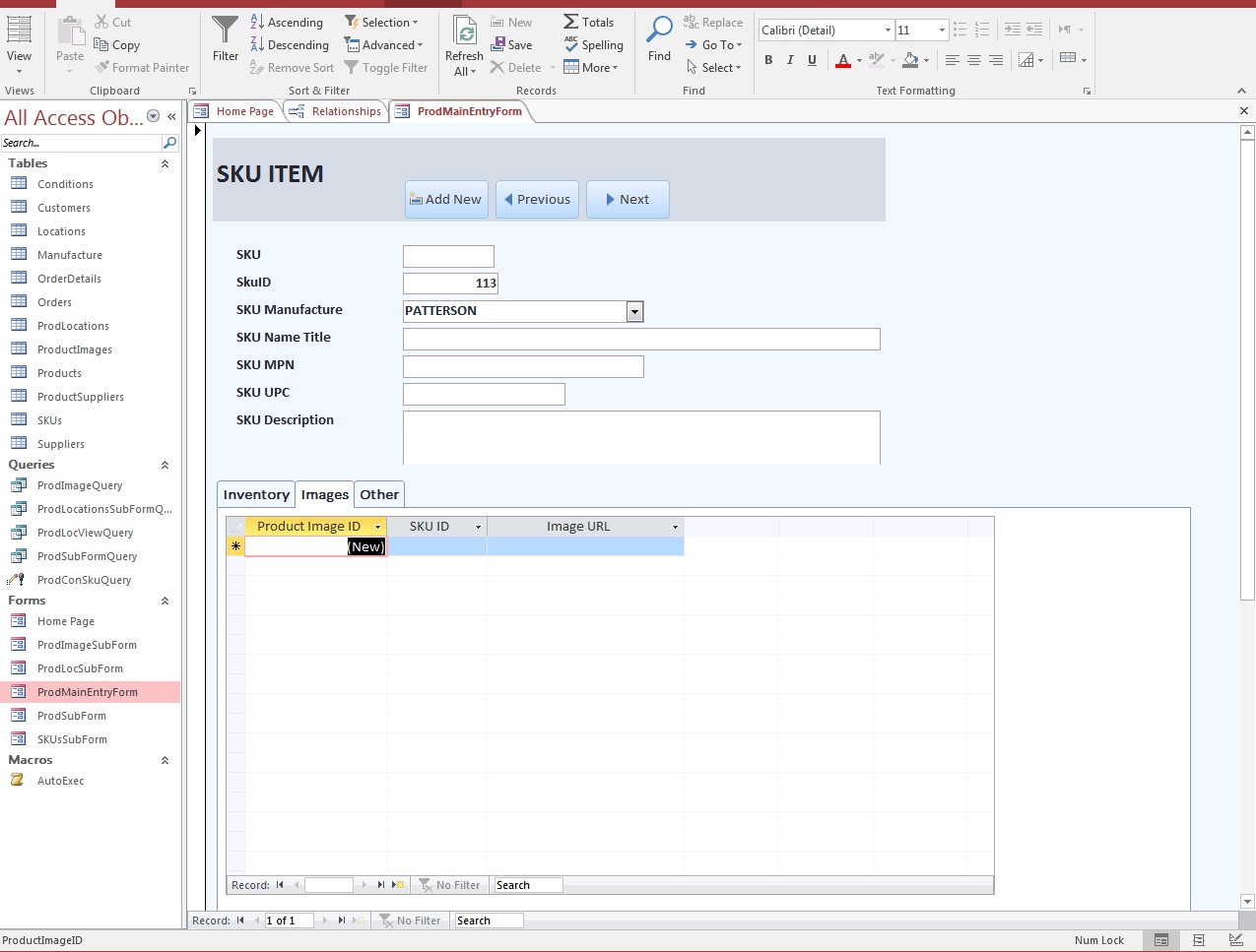

I am going to start off with my "ProductImages" Table.
I made a main unbound form called "ProdMainEntryForm"
I then added my "SKUs" table Subformcalled "SKUsSubForm"  to the top of the unbound form.
I added a tab control of 3 Tabs. 1: Inventory, 2: Images, 3: Other
I made a query to SELECT all my colums in the "ProductsImages" Table. The three colums are "productImageID" , "SkuID" , "ImageURL"
I inserted a SubForm into the Images Tab on the tab control and chose the Query "ProdImageQuery" for the subform.
I will show you the code I made from what I seen in your code and understood.
SELECT ProductImages.ProductImageID, ProductImages.SkuID, ProductImages.ImageURL
FROM ProductImages
WHERE (ProductImages.SkuID=[forms]![ProdMainEntryForm]![ProdImageSubForm]![SkuID]);
I don't need a ORDER do I?
and it keeps  wanting a parameter "Forms!ProdMainEntryForm!ProdImageSubForm!SkuID"
Does the Requery go into the Subform "ProdImageSubForm"?
mine would be this correct?
Private Sub Form_Current()
    Me.Parent!ProdMainEntryForm.Requery
End Sub

Dustin Stanley
Ok "ProdMainEntryForm" is the unbound main form.
"SKUs" is the parent table with the Subform "SkusSubForm"
Subform I am working on is "ProdImageQuerySubForm" in the middle Tab
Walt Forbes
Dustin Stanley
I got it!!
    Me.Parent!ProdImageQuerySubform.Requery
End Sub

It looks to me like the main form is bound (not bounded - bound is both present and past tense).  In that case, it IS the parent and so to requery the subform, you would use:
Me.SubformName.Requery.
Dustin Stanley
Yes in the Master Form called SKUsSubForm I set in the VBA the 3 requeries:
    Me.Parent!ProdImageSubForm.Requery
    Me.Parent!ProdSubForm.Requery
    Me.Parent!ProdLocSubForm.Requery
End Sub

"Someparentcontrolname"  is the Name property of the control you want to move focus to.
Is SKU the name of the CONTROL or is it the name of the field in the form's RecordSource?
This is a case where I would use dot rather than bang because for forms and reports, Access adds the fields of the recordsource to the fields collection of the form/report.
So
Me.Parent.SKU would reference the field in the form's ControlSource
I ALWAYS give controls a name different from the bound field.  This allows me to differentiate in code whether I am referencing the CONTROL or the FIELD.  Textboxes are prefixed with txt, combos with cbo, buttons with cmd, etc.  There are various naming schemes that people propose.  The MOST IMPORTANT thing is CONSISTANCY.
So in my apps this would be
Me.Parent.txtSKU  and I would KNOW that I was referencing the control.
