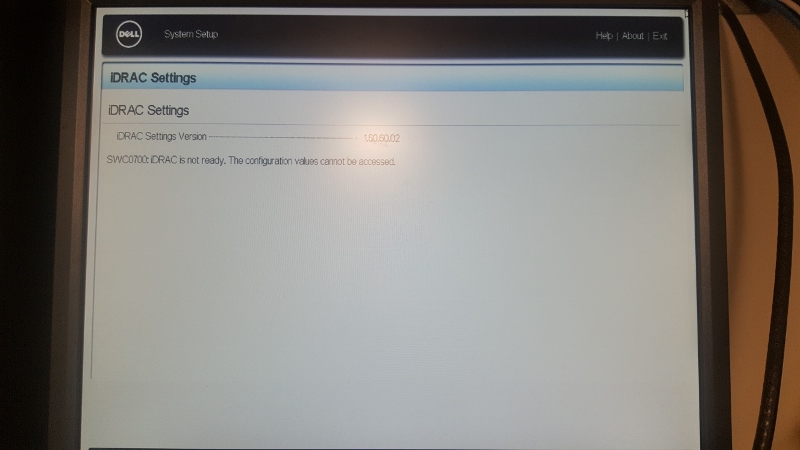

Avatar of PAMurilloPAMurillo🇺🇸
andyadler, these are the images from boot-up.  When I enter the iDrac Setup

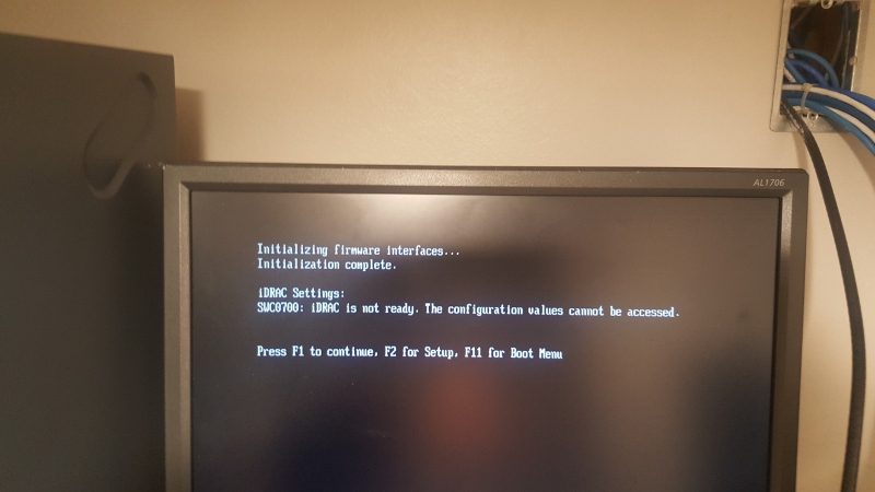

andyadler, I am attaching the boot up including the iDRAC error.  When I go into iDRAC I get the message: iDRAC is not ready
You can try taking the CMOS battery out and leaving it for 5 minutes but unfortunately that rarely fixes this problem and as the iDRAC is integrated on the motherboard then that needs to be replaced unless you jusr put up with the noise and the lack of remote management. T430 is fairly recent model though, it may be just inside warranty period.

andyadler did answer the question correctly.  The issue was the motherboard and it had to be replaced.
