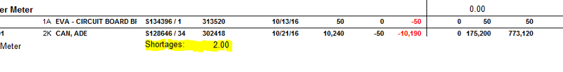

Main view, note that only the first group has a correct count, even though reset formulas have been used:
main
Drill down, this is of the second instance of the group - the group footer displays a total count of zero, but in the drill down, that same group footer shows the correct count of 2:
drill down

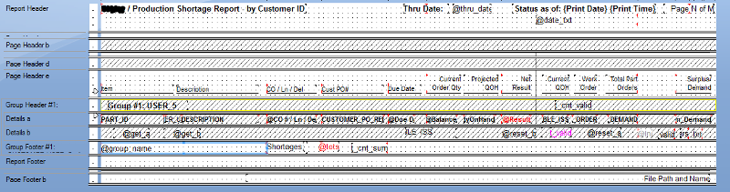

I never really used drilldown, but the problem seems to be that drilling down only goes down one level at a time, and you have GH2a suppressed (and GH2b and GF2 have 0 height, so they don't show either).  When you drilldown on group 1 (GF1), it would open group 2, but the group 2 headers and footers are suppressed or have 0 height, so you can't see them.  If you unsuppress GH2a, or make GH2b or GF2 a little taller, so that they show up, then you can double-click on one of those to get the details (I tried that and it worked in your sample report).
 You probably don't want to see all of those group 2 headers or footers, especially since it seems like, in a lot of cases, the details are suppressed if you drilldown.  If you only want to see the group 2 header or footer (whichever) if there are some details to show, it might be possible to conditionally suppress them.  Since you're using a variable to conditionally suppress DetailsA, your best bet would probably be to make GF2 larger and conditionally suppress it.  For example, use a variable to store a count of the details in group 2 that aren't suppressed, and then suppress GF2 if that variable is 0.  If you try that, don't forget to reset the count to 0 for each new group 2 (eg. in GH2).

 In your screenshot, you have a bunch of GH2a, GH2b and GF2 sections.  Did you try double-clicking on those?  That should show the details in that group 2.  In some cases you have all of the details in a group 2 suppressed, so you won't see any details for those groups, but you should see details for some groups.

I you run the sample report, the result shows just the PH's and GF1, as it should.  However, when I drill down, I'm only getting RH, PHa, PHc, GF1 and RF. - no details section.
As I was saying, I have the exact same report for another customer grouping, and when I drill down, I get the PH's, GH1, Da, GF1 and RF.  I just can't figure out why the two reports are functioning differently - data is in the same sections.
