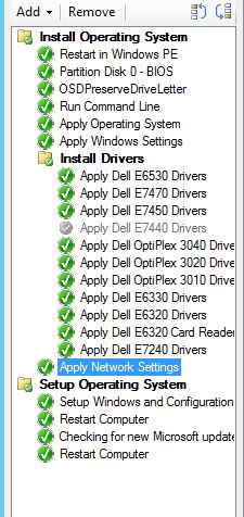

My  task sequence  is attached

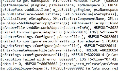

it  runs as expected, except  failes  after sysprep   with  error
Windows PE initialization failed with error code 0x80220014. THe   image  continues  to  run  and  iam greeted  with the OOB   experience
After a   few  googles  seems  that  i  need  a hot  fix, as  i am running WADK   Windows PE v10.0.10586  are  you able  to  confirm?
also  in  my  first  messge  There  is a image  of  my  task sequence   and  i  havea reboot  after updates
If  i  use  the  task  "check  for  microsoft  update "  using   ZTIWindowsUpdate.wsf  it  apears  to   hang !, But  will complete  after  i  reboot,
Or  should  i  just  use the task "install software Updates"

Working last first, yes task just use the "install software Updates" step. This assumes you have set up SUP (with WSUS) already though? Have you done that?

The error you have is: Error. Received 0x80072ee7 from WinHttpSendRequest.
It starts to go wrong earlier with Start executing an instruction. Instruction name: Apply Device Drivers. Instruction pointer: 6
"Unsuccessful in finding a suitable device driver for device 'Motherboard resources'."
if you are applying a driver package then remove it. The reference image needs to have NO drivers injected at all. It uses native OS drivers for disk and network. Those are the only two you ever need. You definitely don't need these:
  File: http://<snip>.com:80/SMS_DP_SMSPKG$/BBF2CEE8-1C09-493D-91F4-A2EA9B32D65D/sccm?/amdkmpfd.inf.
This is bad if it worked because now your reference image has AMD network drivers in, regardless of whether your physical kit has AMD anything. Potentially it can kill the Plug and Play enumeration.
So the step works (Successfully completed the action (Apply Device Drivers) with the exit win32 code 0) but it has to do lots of unnecessary weeding.
Step 8 is Install updates - I would grey that out for now.
It fails anyway (This operation returned because the timeout period expired. (Error: 800705B4; Source: Windows). This is a known issue if you have *too many* update pending. If SUP is not setup correctly though it will fail too. SUP is a much later chapter in Kent's book.
Finally got to the problem: "Found network adapter "Intel(R) PRO/1000 MT Network Connection" with IP Address 0.0.0.0." and then machine reboots and stages WinPE on the D: drive before this:
which points to there being no network drivers. See this article, by err, me:
https://4sysops.com/archives/sccm-windows-deployment-troubleshooting-part-3-networking-issues-xml-and-media-errors/
That's another reason why capturing on a VM works better than a physical box. There are no drivers to worry about, so you don't have to mess about - it just works.

Anyway i  reran  the capture  with  the  nic  removed  from the  boot  image  and  no  updates selected.
runs  well  after  sys  prep  it  fails  again   ""Windows PE initialization failed with error code 0x80220014.""
which  is the capture stage ,   is  this  due  to  it  needing the hot  fix  or an other issue ?
When  i  look through the  logs  i  see  Remediation failed with error code 8027000C which  i  believe  is  networking  issues , thats  why  i  originally   added  the  driver . Am  i  missing  the  point   here ?
