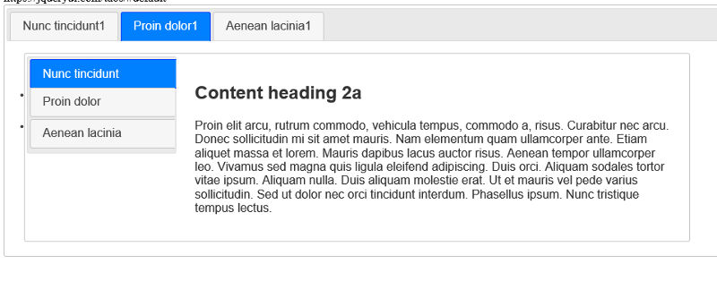

Attached are the html and css for code I am having problems with. I am using the examples provided at https://jqueryui.com/tabs/#default and making a page with both horizontal and vertical tabs. It works great, other than that when I select the second horizontal tab, its vertical tab has bullets on the left. If I click those tabs, the bullets disappear, but I don't want them to show in the first place.
screenshotAlso, I'd like to remove the borders, and the shaded background on the tab panels. I'd also like the vertical tab panels to not be have a left indent - to be flush on the left. Can anyone help with that? If not, at least the first problem with the bullets. Thanks!

Starr DuskkASP.NET VB.NET DeveloperAuthor Commented:
Julian, Second tab, are your bullets.
julian bullets
the border:none;
didn't remove my borders.
I added that style within my document under the other scripts and also in my css at the very bottom. Are you sure that's all you did to remove yours?
I also viewed source on yours and copied the entire document as a new html and ran it, and when I run it, with my css file, it still has the borders using your html source. So did you do anything else to the CSS file itself?
thanks.
Julian HansenCommented:
Ah - Internet Exploder ... I was using FF / Chrome
For some reason IE is interpreting the list-style: none on the <li> element as being an override on the <ul> parent.
Will take a look and post back.
I found the solution to removing the borders, it is this one:
    .ui-widget.ui-widget-content{
        border: none !important;
but still looking for the bullet problem resolution.
This appears to be a bug with IE11
The following seems to fix it
  .ui-tabs-nav {list-style-image: url(data:0)}
  .ui-tabs .ui-tabs-nav li {list-style: inherit;}
Updated sample here
Wow! Thanks so much! you're the best!
