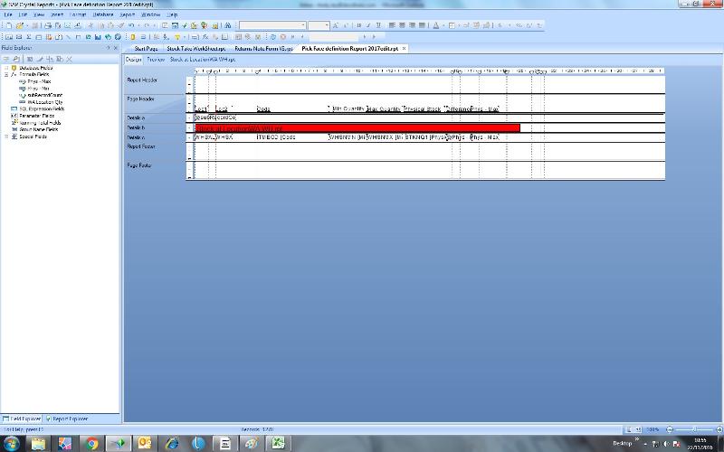

Thank you for your response, I feel I'm not that far away but cant put my finger  on it, i have included a screen shot.User generated image

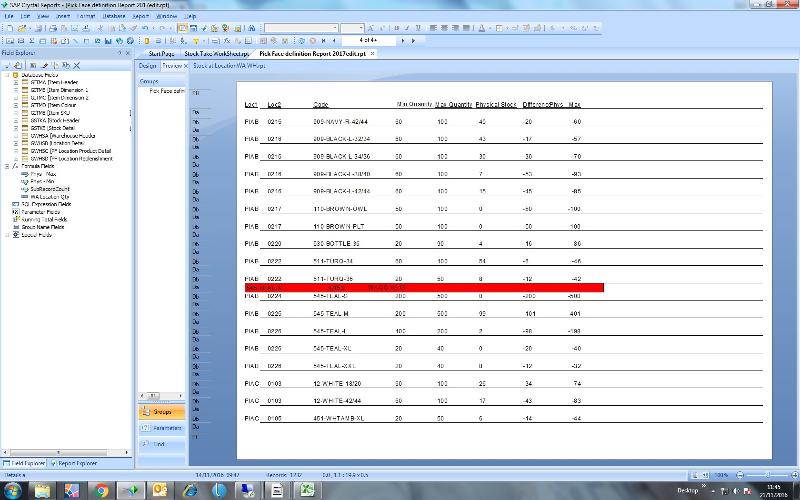

This is what the report looks like with 2 detail lines, the formulas have been created in both main and sub reports and the next step is to insert the suppress formula:

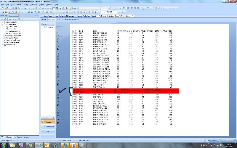

Below is a shot of the first record the report has detected where stock is in the bulk warehouse, there are lots of records before and after that in theory i shouldn't be seeing.  This then continues right to the end and the report is 30 pages long.

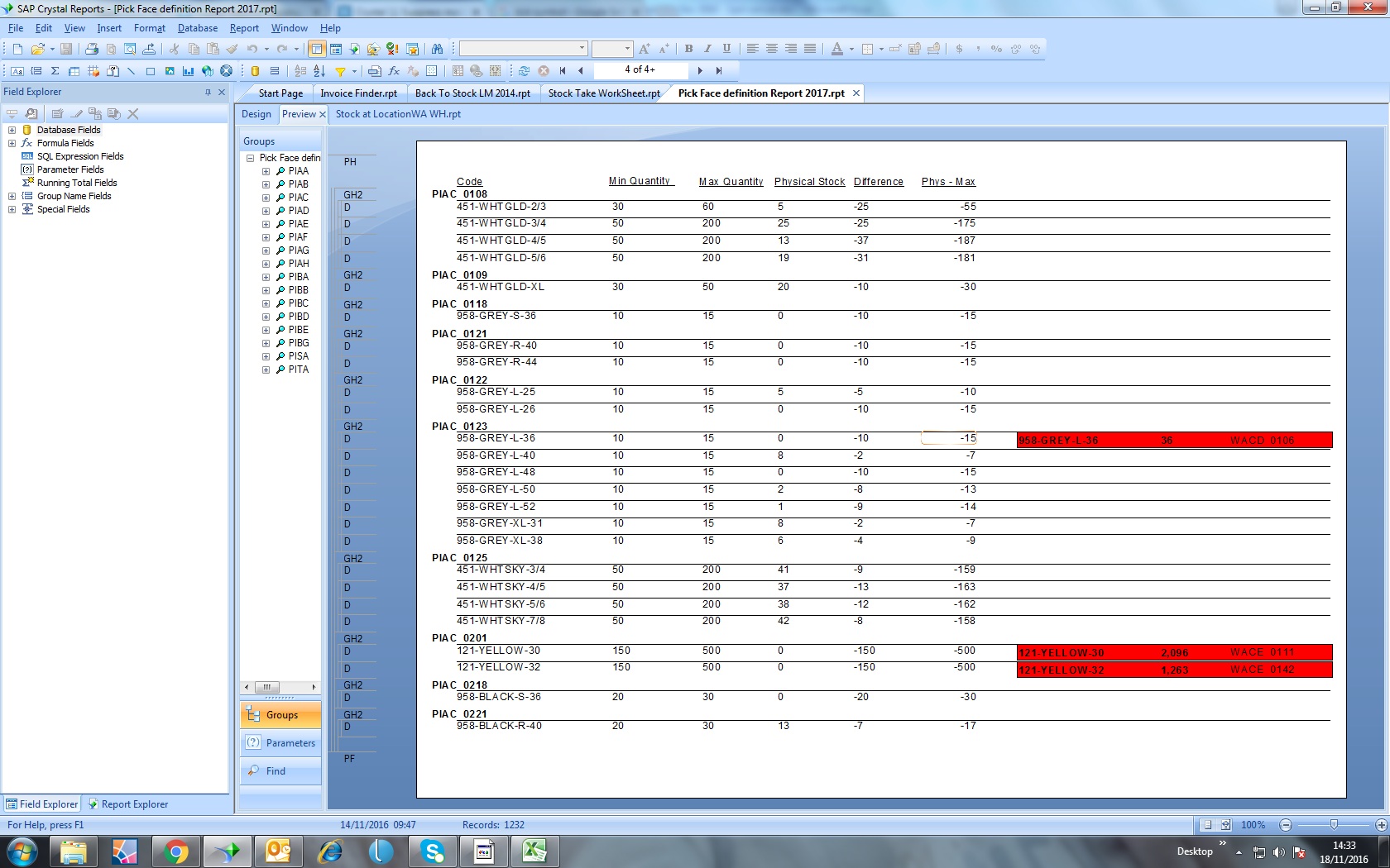

I have shown below how the design of the report looks, I believe I have set it up correctly but if you can spot anything from this do let me know :-)

Thank you both James and mlmcc for your contribution, James' final response has hit the nail right on the head and has certainly give me a positive start to the morning.  It seems the general theme with crystal in that people just learn as they go.
