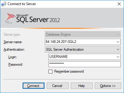

This is an odd one that I've never seen before. I'm hoping someone can shed some light.
I have a SQL Server database with a default instance and a named instance. For the sake of this conversation we'll call the named instance SQL2.
Using the local IP address I can connect to the named instance just fine. See screenshot below.
working - localHowever, using the public IP address the connection fails. See similar screenshot below. (Public IP address is made up)
not working - publicFurther complicating things is that if I use the explicit port number instead of the named instance it works again.
working - publicI've never seen a case of a named instance failing to connect like this. There must be some kind of configuration issue I'm overlooking. Can anyone suggest a solution?

Please read the following article: Configure the Windows Firewall to Allow SQL Server Access, URL: https://msdn.microsoft.com/en-us/library/cc646023.aspx
Relevant points:
1_
SQL Server default instance running over TCP TCP port 1433
2_
SQL Server Browser service UDP port 1434 The SQL Server Browser service listens for incoming connections to a named instance and provides the client the TCP port number that corresponds to that named instance. Normally the SQL Server Browser service is started whenever named instances of the Database Engine are used. The SQL Server Browser service does not have to be started if the client is configured to connect to the specific port of the named instance.
3_
Entire subsection Configure a Windows Firewall for Database Engine Access, URL https://msdn.microsoft.com/en-us/library/ms175043.aspx
Document portion
A_
To open access to SQL Server when using dynamic ports
In the Program dialog box, select This program path. Click Browse, and navigate to the instance of SQL Server that you want to access through the firewall, and then click Open. By default, SQL Server is at C:\Program Files\Microsoft SQL Server\MSSQL13.MSSQLSERVER\MSSQL\Binn\Sqlservr.exe. Click Next. ( please note, application Sqlservr.exe location can differ in actual installation )
To summarize, ensure the following ports are opened for successfull connection to SQL Server:
UDP port 1434
TCP port 1433 ( Default instance )
TCP port for application sqlservr.exe ( Named instance dynamic port configuration )
-- cheers

I'm looking into the SQL Server Browser service. The perimeter firewall may be blocking UDP traffic on port 1434. Unfortunately I don't have access to configure that firewall so I've submitted a request. I'll get back to you.

What for do you need the SQL Browser service running? This is only needed if you use Name Pipes protocol. Is that what you want?

Opening Port 1434 to UDP traffic did the trick.
