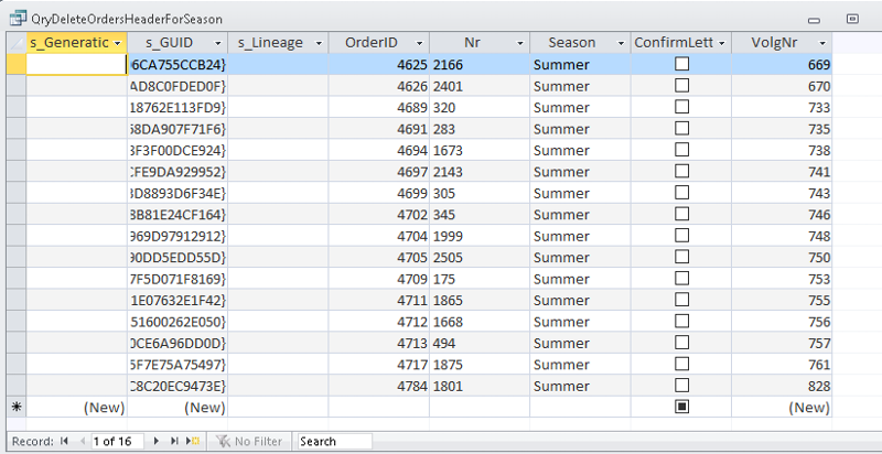

In the query builder it looks like here:
Looks like in builder
The result from the select query is like
Records that will be deleted
I do not manage to make a working delete query. Will you help please.

Rey Obrero (Capricorn1)Commented:
try this query
Delete TblOrdersHeader.*
 FROM TblOrdersHeader, tblDeleteOrdersHeaderForSeasonSelect
Where  TblOrdersHeader.OrderID In( Select tblDeleteOrdersHeaderForSeasonSelect.OrderID From tblDeleteOrdersHeaderForSeasonSelect)
Fritz PaulAuthor Commented:
Thank you very much.
