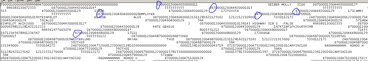

I need to create a batch file that gets rid of the carriage return. The delimiter looks like a square [].
I attached what the file looks like and highlighted what I see the carriage return as and also another file what the expected output is ..
Any ideas how this can be accomplished

Two things to try and see if it helps.  Either:
type filein.txt > fileout.txt
or
more filein.txt > fileout.txt
~bp

This solution worked ! Thank you very much
