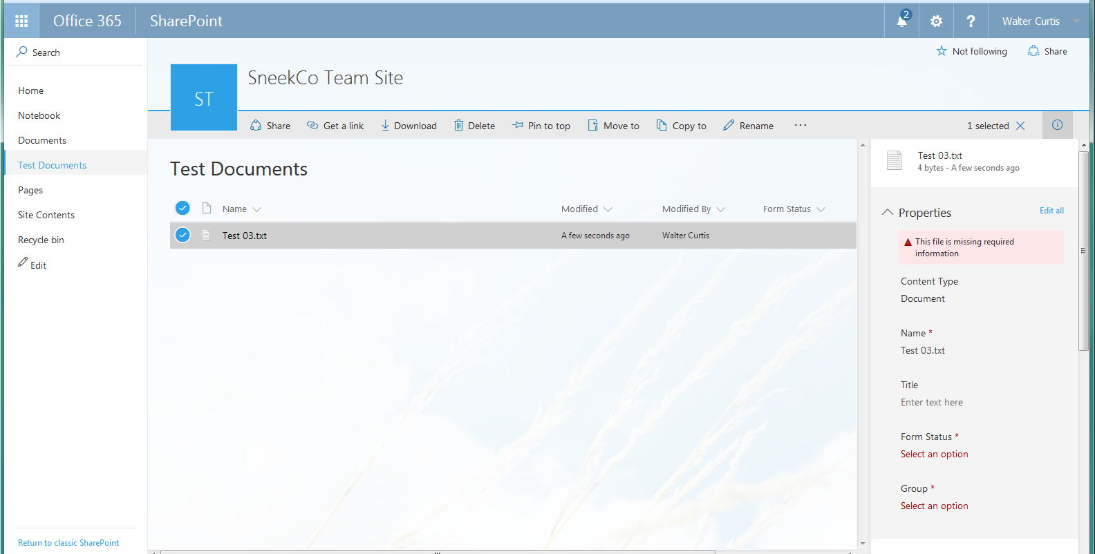

Good point:
Let's say the user just wants to upload a file, they don't want to mess with InfoPath or a popup after the fact demanding metadata.
But a standard system will offer the opportunity to enter the required data automatically with no need for any additional programming.
This screenshot shows SharePoint online, but all other versions have the same functionality, out of box.
Good luck...

I think I am over thinking things a little. Making those field required maybe the best solution. Â If that doesn't work, making a content type and then using info path maybe the best backup plan.
