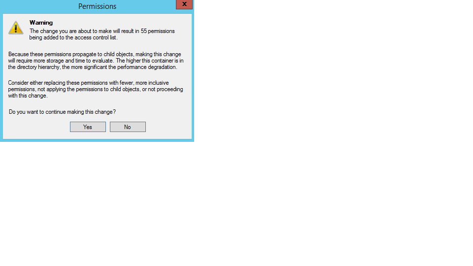

The 2 users that have a problem currently has inheritance disabled. It is server 2012 so there is no tick box. Only disable or enable inheritance.
Should I enable inheritance? Will it not cause problems? These accounts belong to my directors.
Please see the attached warning?
